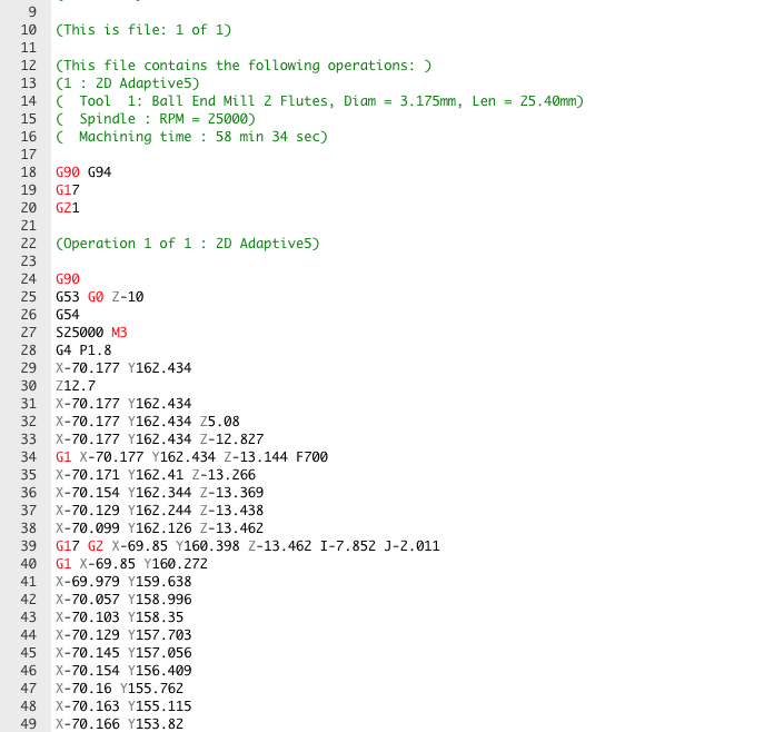

I've got my Lead machine up and running, I generated a tool path and Gcode in Fusion 360, and I get errors when I try to run the code in CONTROL. The machine stops when it hits red text in the Gcode, as shown in CONTROL. I have attached a screenshot. I'm not really sure what to make of this or how to fix it, looking for some insight.
Colors inside the editor is insignificant, its just cosmetic. The errors come from Grbl, not CONTROL: gnea/grbl (refer list of supported GCODES) Make sure you use the correct Post Processor: Fusion 360: grbl post processor install (the easy way)
