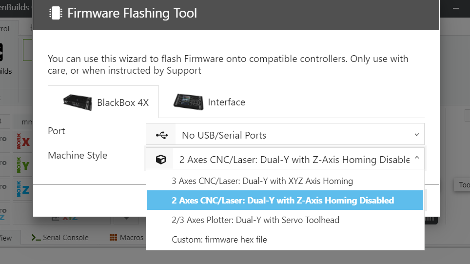

    My stepper motor is homing at an incredibly slow rate, so slow that I can barely detect any movement. What could be the issue?

  5. Giarc
    2,992
    1,670
    You say ignore the Y and Z, so you are only using the X. The problem you may be having is that the machine is waiting for the Z to home first since Z always goes first. If Z never homes, then X and Y can't start. However, there is a 2 Axis version of firmware you can flash that removes the Z axis.
    14,701
    4,249
    And did you recompile Grbl to disable Z and Y homing? The precompiled image for 2 axes would still error out waiting on the 2nd
  7. Ankit Kumar
    Jun 23, 2022
    16
    That was it! I connected the stepper to Z-axis, and the homing started well. However, as expected, homing didn't finish because grbl is trying to also home the other two axes.
    Is there any easy fix for this issue? Something I could edit in the grbl library?
