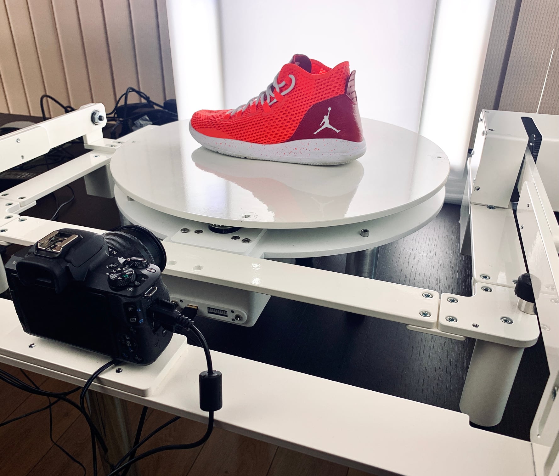

    Currently the options are to purchase an extremely expensive booth or system to do this OR use a tripod, an extension arm AND a tape measure etc to work out EXACTLY where the camera needs to go.
    Upon looking at the picture above, which shows a prototype one of the turntable companies are working on, we realized that the expensive rigs really are just fancy versions of this. To do MR360 correctly you must make sure the camera is the exact same distance and angle from the piece at all times. The easiest way to do this is to not have the camera move around at all but to keep it fastened to a bar that moves it in an arc around the piece.
    Here are the main things that the rig needs to do.
    1. Most importantly the side arms need to be able to elongate depending on how big the piece you are shooting is. This allows the camera to be nearer or further from the piece. The same length at any angle.
    2. The side arms need some sort of gear and sprocket type device to allow you to move and lock the arms into place . Something like how you lock in the height of your front mower wheels but with a lot more accuracy. This might be on both sides or just one side with the other just attached to a bar so it can move freely. Sure a motor would be nice... but sprockets are just fine if it saves us $300 etc
    3. The camera needs to have a simple cold shoe to screw the camera down to, in the middle of the front bar. It cannot move at all. It must take the same exact picture all through the arc. We have many of these and could easily just sandwich one between the bar and an attached plate.
    4. There must be a bottom piece with adjustable legs (for leveling) that this "C" shaped arm must lay on that holds it into place. The one in this picture seems to be balanced enough that no weight is needed to anchor it and no back wall is needed. However we can see adding small photography sandbags to hold it down. Or even to attach a plywood bottom so that these bags could easily be put inside to keep it held down.

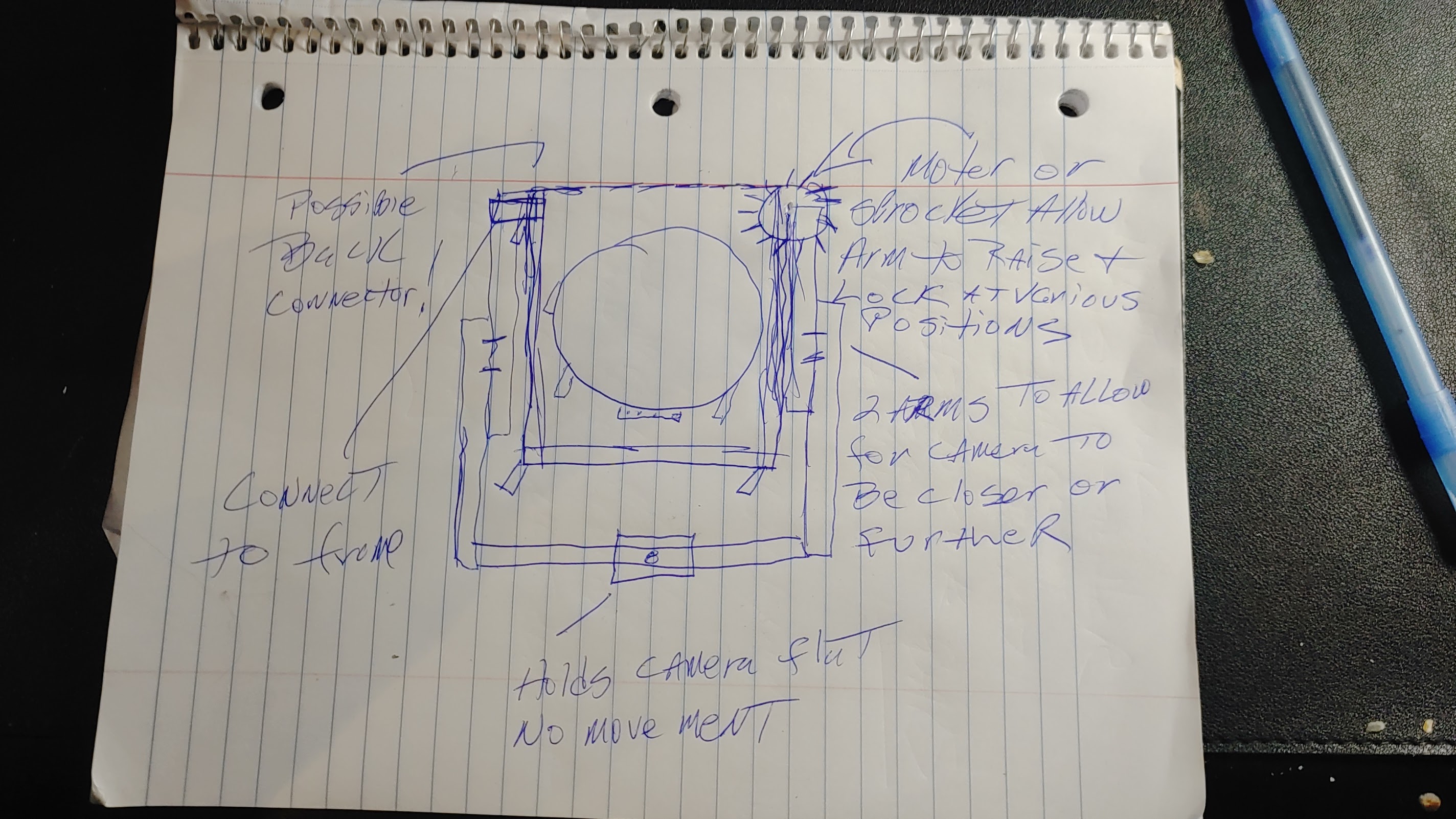

    Below we insert an extremely pathetic drawing of what we describe above. This is to both educate and amuse you. Look we are comedians... stupid ones from NJ at that!
    Anyway, this is where you come in. We think with the right parts we could build one of these pretty easily and cheaply and we were hoping you might be able to suggest to us what we need to purchase from you to do the job??
    If you can't help us with that, any idea of someone that might??? Seems like the rig in the picture is pretty much put together out of parts in the first place so we are hopeful.

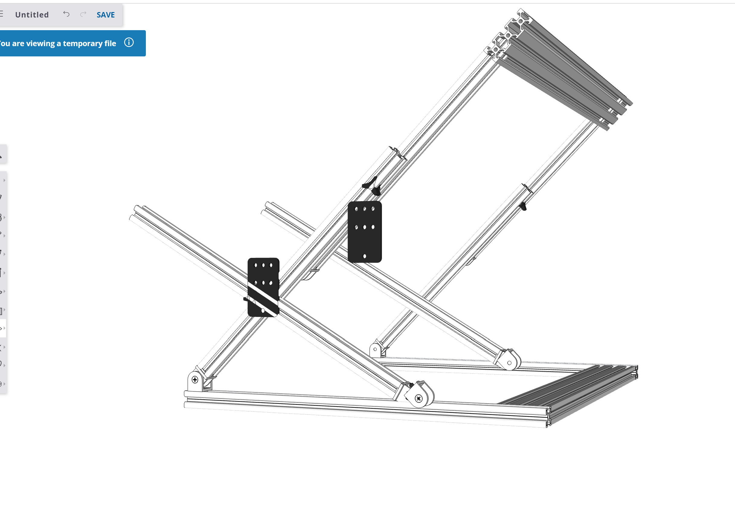

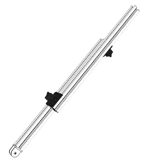

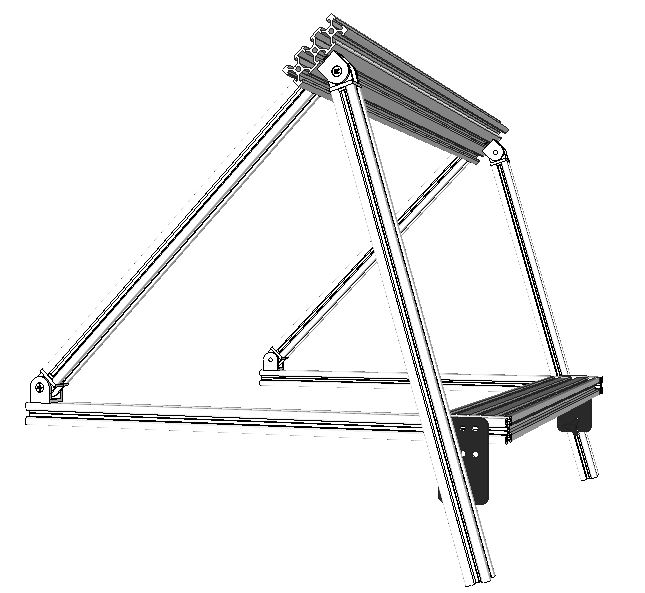

    If all you're looking for is a propped frame to hold the camera that's fairly simple.
    Uses a star knob through a plate threaded into a T-nut set in the channel in the prop leg to set the height. You'll probably want to add a washer between the plate and the prop leg and you'll need to cut the star knob to an appropriate length. The system is hinged using Adjustable V-Slot Hinge - OpenBuilds Part Store.
    Rough Sketchup file attached. Full connections not shown and you'll need to adjust what is shown to be more in line with what you're needing.

    I think this could work but just need a few changes
    Please note I have no idea how to use this program and I attach my version of skp file and screen shot below
    I think if we flip the prop leg so the star knob is at the top, and move it up the frame a bit that would make it work better. Note that the plate on the rear is not in the right place
    Also we had mentioned that we needed the side arms to telescope so we can make the entire piece longer. I added a set of star knobs to hold in place but perhaps there is something sturdier to hold the 2 arms and let them slide along their side?
    what do you make of this mess??
    thanks
    Here is the skp file, thought it's quite ugly lol
    https://drive.google.com/file/d/16esCnNVHpjvMXEdS2mxBvw0nTeJqCfhO/view?usp=sharing

    Seems workable. Also an admirable first time effort with Sketchup.
    As for the extension part in the center, I suggest taking 4 of the idler plates and trimming them down to around 38mm wide, trimming off the single hole and leaving the 6 hole pattern. Mount the plates near the end of one side and connect to the opposite side with a star knob and t-nut as shown below.
    Ideally both plates should be on the bottom side buts spatial constraints may require them both on the top. Sketchup file attached.
    Please show us a final build on what you come up with.

    1. The sled:
    Extrusions as noted above except 20x60 will need to extend beyond side rails approximately 25mm each side such that you have a place to mount the hinges for the prop arms. Side rails will butt into the 20x60 and be attached with cast corner brackets.
    4 hinges
    4 M5x8mm screws to mount hinges to sled
    4 t-nuts to mount hinges to sled
    8 end caps End Cap - OpenBuilds Part Store
    8 M5x10mm screws for end caps
    4 cast corner brackets
    8 M5x8mm screws for cast corner brackets
    8 t-nuts for cast corner brackets
    2. The prop arms:
    Extrusions as noted
    2 M5x15mm screws to attach hinge to end of prop arms.
    2 idler plates
    2 star knobs
    2 t-nuts for star knobs
    2 oversize washers
    6 M5x8mm screws to hold plates to extrusion
    6 t-nuts for screws to hold plates to extrusion
    2 end caps
    2 M5x10 screws for end caps.
    3. The expandable arms:
    Extrusions as noted. Side rails will be attached to the camera support with blind connections. Blind connections are fairly simple. The screws are tapped and threaded into the end holes of the 20x60 member with just enough sticking out to where you can slide the facing channel of the 20x20 up over them to where the screw heads (with washers) are locked into the channel. Prior to doing this though you will need to drill 4mm holes through the center of the extrusion at 10mm, 30mm, and 50mm from the end where you can insert an allen wrench through the holes and tighten the screws embedded into the ends of the 20x60 channel.
    6 M5x15mm screws for blind connections
    6 Precision Shim - 10x5x1mm - OpenBuilds Part Store for blind connections.
    2 M5x15mm screws to attach hinge lower end of extendable arms.
    6 end caps
    6 M5x10 screws for end caps.
    4 idler plates
    4 star knobs
    4 t-nuts for star knobs
    12 M5x8mm screws to hold plates to extrusion
    12 t-nuts for screws to hold plates to extrusion
    Questions:
    1. It shouldn't unless something is noted to be stuck in Long Beach Harbor. Shipping is M-F and if everything is in stock most orders are out the next day.
    2. No 90-degree Makerlinks
    3. One piece will need to be 130mm longer than the other.
    4. Most use chop saws with aluminum cutting blades. But if you know what lengths you want just note it in the comment box on the order and the shop will cut it for you. You'll probably want to go through and recalculate the lengths as I have altered most of them. The base sled arms will need to be shorter and the prop arms will probably need to be longer.
    5. You're gonna need to start over on the estimate. You'll need to organize the quantities listed above. Remember screws and T-nuts come in 10 packs.
    Good luck. I believe the listing above is complete but no guarantees.

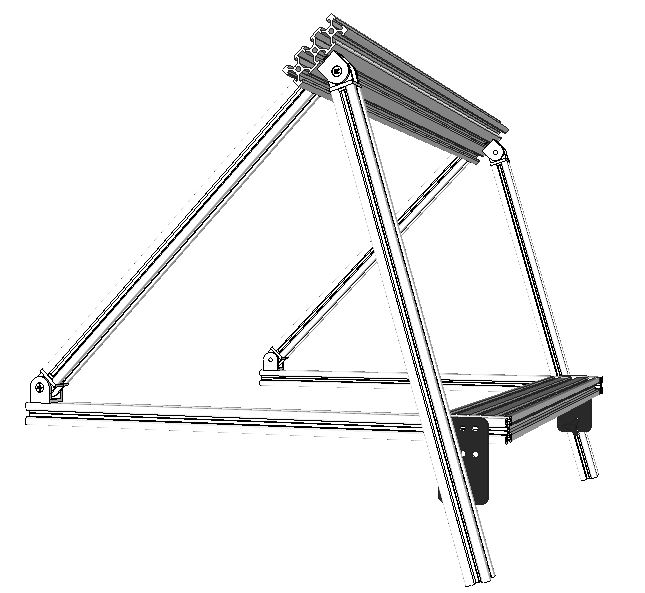

  13. Rick 2.0
    2,892
    1,549
    Why the base piece is 130mm longer you can see in the sketch below. The base sits outboard of all the arms and the camera mount extrusion sits inboard of all the arm extrusions.
    As far as individual piece lengths of all the arms, it's up to you to determine how big you want this and to work from there.
    No, the 90-degree t-nuts will not work for this project. If you wish, you can use 90 Hidden Tee Nut - MAKERLINK (10 Pack) - OpenBuilds Part Store to mount the camera support extrusion to the side rails rather than the blind screw connection method. If you make the base support another 15mm longer you can also use the 90 Hidden Tee Nut - MAKERLINK (10 Pack) - OpenBuilds Part Store instead of the cast aluminum corner connectors. (You don't have to make the base support longer but if you don't the hidden t-nuts will stick out the end about 7mm) As far as 4mm screws for the hidden t-nuts you don't need them. All the Makerlink connectors come with set screws.
    New Sketchup file attached.
    The camera mount extrusion is connected the way it is because it offers greater strength. The base extrusion is mounted the way it is because there is no other choice.
    Sorry guys but this is as far as I take it. Best way to learn as a maker is jump in. Now it is your turn to take this to fruition.
