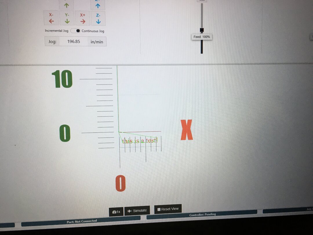

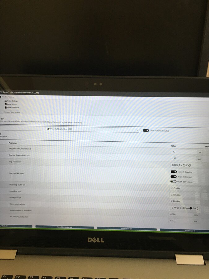

    I have a Workbee 1510 using a Blackbox and Openbuild Control Software. I also use Vectric Inspire and/or VCarve 10 for my projects. I have been pulling my hair out trying to fix this problem. I made a simple carving "THIS IS A TEST!" using Inspire 10 and saved it using multiple Post Processors (Openbuilds-incg GCODE, GCode, TAP and a few others) but the project ALWAYS runs upside down and backwards. I set work zero (as you can see the X in the lower left corner of the picture) and set the work to be carved at the TOP. No matter what I do, as I tried inverting the Step Pulse and some other stuff, it will al IMG_0077[1].JPG IMG_0077[1].JPG IMG_0077[1].JPG ways head to the bottom of the work and carve backwards, as can also be seen in the pictures.
    Hopefully, there is a simple fix for this, but I have not found it yet.

    OpenBuilds CONTROL > Grbl Settings tab > Look down at Step Direction Invert
    and flip any axis that needs to run the other way
    Refer to gnea/grbl for more info

    Thanks Peter. Yes, my X and Y Axis’s are correct. I use the Control Program and all my Axis’s move correctly as + and - and Homes correctly, so I assumed I had the Step Direction correct. If I invert the X and Y then wouldnt the jogging be reversed?

    Yes, I inverted both the X and Y plus inverted the Homing for both. I Homed the machine then set Work Coordinates and found it still did the same thing. I changed the starting position in VCarve to a different corner pf the work piece but all tis did was cause the machine to look for the material in a different part of the machine.

    Flipping Y will change top to bottom. Flipping X will mirror the text (right way round or reversed)
    Your picture still very much looks like X and Y swopped with each other - its rotated 90 deg clockwise, along with what looks like X being inverted) if I compare the screenshots.

    In the pictures, you can see that, using Aspire, I have the XY Datum Position in the top left corner. I generated my toolpath and saved it with Openbuilds GRBL (inches) (*GCODE). As you can see, when I open it in Openbuilds Control, it lines up in the Y Axis negative. Also, if I “run” this as it is, it will run very small, as if it is saved in mm and not inches.

    Still doesn't explain why its rotated through 90 deg, or is the pictures in your first post incorrect (looks like text is vertical along the right hand side?)

    Sorry again Peter. In the 1st Post pictures, the camera was turned 90 degrees. The X in the lower left corner is actually in the upper left the same ad the latest pictures.

    I can get it to cut the letters properly, but when the job is loaded into Openbuilds Control program it shows that everything is on the Y negative axis. Also, to cut the project properly I have to have my jog controls reversed ( the + goes towards the - and the - goes towards the +)

    Thats showing you have material origin set as top left in your CAM. The viewer justs zero where the gcode says it is

    If the text its still reversed, just address it with Grbl settings:
    If you are referring to where it sits in the preview, thats on You:
    You set the origin as TOP LEFT: So the preview is 100% correct, your job will be off in Y negative
    Added red notes to your picture
    Which results in exactly the same here: X0Y0 is off at "top left" of your job, and thus the gcode is down toward the Y negative
