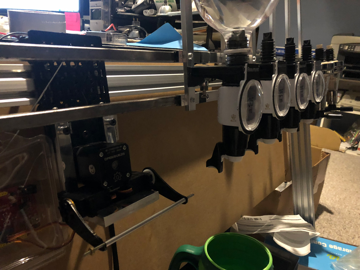

    I am working on a project (off and on for a while now!) LOL.... and finally getting back around to work on things..
    This is not the normal "CNC" project (no router...no gcode..etc)..
    However, I did use the V-Slot rails to build it.. so I am coming back to get some feedback on how best to approach my current obstacle.
    Quick-n-Dirty:
    I'm building a barbot..or maybe better described as an automated drink maker?
    There are many that have done this before me.... but I wanted a stepper motor project.. and this project inspired me to 'make it happen':
    There are many variants... but the above was my motivation (mine has a touch screen menu though, and doesnt have the rails on the 'bottom', but suspended, under the drink/optic measures.... take from another project viewed)..

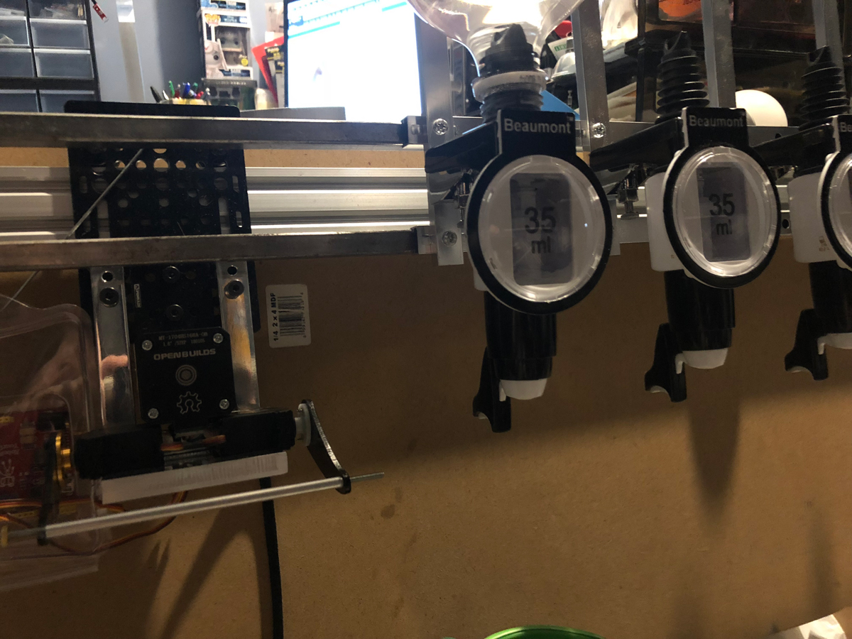

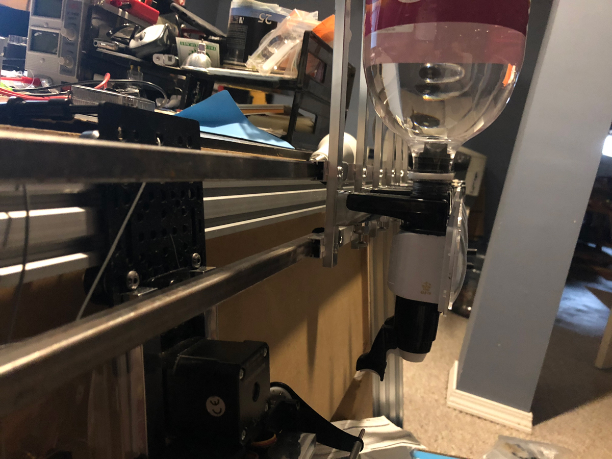

    Anyways.. my current 'issue' is that, while I used some v-rail for the main rack-n-pinion set-up for the stepper to more the carriage/platform around..
    My initial mock-ups used 2 x .5in steel square tubing as the pieces to support the 'optics' and the actual liquor bottles as well.
    I only have 1 2-liter (filled with water) for testing purposed.. (while I work out the other mechanics of the project)..
    and noticed that I dont think these 2 pieces of square tubing will be enough to hold everything properly??
    I fear that it may 'bend' horizontally from the 'load' of 6 liquor bottles..
    -AND-
    that it may 'skew' or warp..(not sure how to best describe it).. once the servo under the dispenser is lifter and attempts to press the opitc measure 'stem' piece to dispense the liquor.. (hope that makes sense?)

    I was thinking of perhaps replacing it, [those 2 x steel tubing pieces], or perhaps adding to it, (since the dispenser piece(s) fit nicely to it)..
    with a piece of x-rail 20mmx80mm..
    thinking this would perhaps be more sturdy?
    Here are some pics..
    more or less.. looking to replace those 2 'bars' with something more 'sturdy'.. between two 'v-rails' that are being used as 'legs'.. so I can mount those 'bottles' to it. and have it not move, bend or flex. :)
    My initial thought was to try and use a piece of 20mm x 80mm... but this is my first experience with linear rail stuff.. so I figured I'd pick your brain and see if there was a better idea to try?

    Cool project. I would move the rails for the Glass holder down lower and then use multiple braces for the dispenser rack.

    Lower the 'back rack' (the glass holder),.. which really isnt there yet.. it attaches to the carriage in the images.. so its placed below the measure/dispensers.... what you see there (in the pics) is the 'servo platform' that will engage with the optic measure 'stem' depressing it and dispensing the liquid.
    In fact it could probably help to go even an 1/8 higher! LOL (for leverage in making connection between the servo/arms (horns) and the stem piece..

    My current (only?) obstacle is how the bottle older/dispensers are mounted/secure to the 'legs'.. and because it has no 'back' (not solid... which I like).. I'm worried it might not:
    A.) be strong enough to hold all the bottles/weight without flexing/warping
    or
    B.) when the servo (from the bottom) pushed UP on the dispenser/stem piece, and the steel tubing will warp/twist (without having any back support, especially in the middle area)
