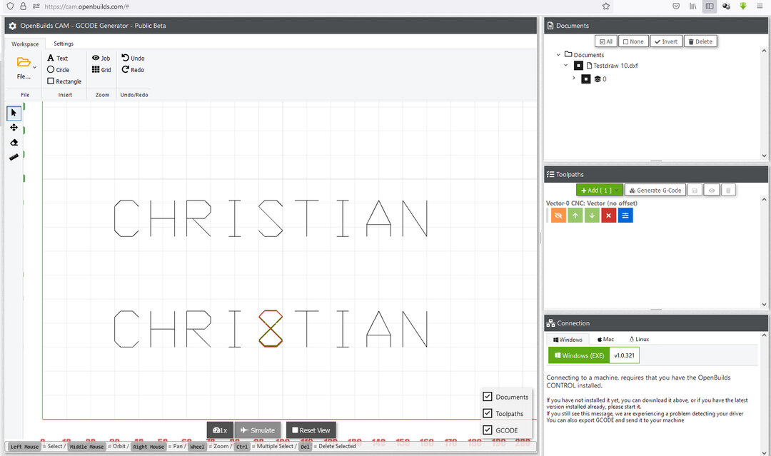

Hello, I am trying to mill letters. Yet when the toolpath is generated, the spindle does not lift when the next (i.e. deeper) path is milled, resulting in unusable scriptwork. The file comes from AutoCad. What am I doing wrong ? Any help is appreciated, Anselm
Check your toolpath parameters. You can include a OBC (File > Workspace Export) for us to help you check

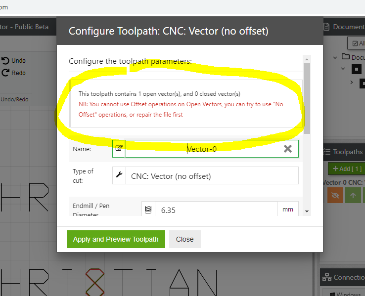

The toolpath editor already warns you about what's wrong: You can't really use Open Vectors: See docs:software:file-errors [OpenBuilds Documentation] Might do a single pass engraving, certainly not a multipass cut using open vectors.
Hi Peter, Thank you for your prompt reply. Somewhat strange though that the system is not able to generate proper multipasses for open (no offset) loop vectors. Greetings from Geneva, Anselm
