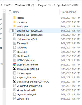

    Inside the application. Where you loaded your machine profile when you first set it up... Run CONTROL, Open it. With the application open, connect to the BlackBox. Click connect. Wait for it to connect. GRBL settings tab appears. Click on it. There's a toolbar across the top, on it, a button called Backup Settings
    #24 Peter Van Der Walt, May 25, 2021
  25. eric bultman
    Jan 6, 2021
    15
    This is what it gives me
