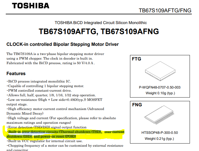

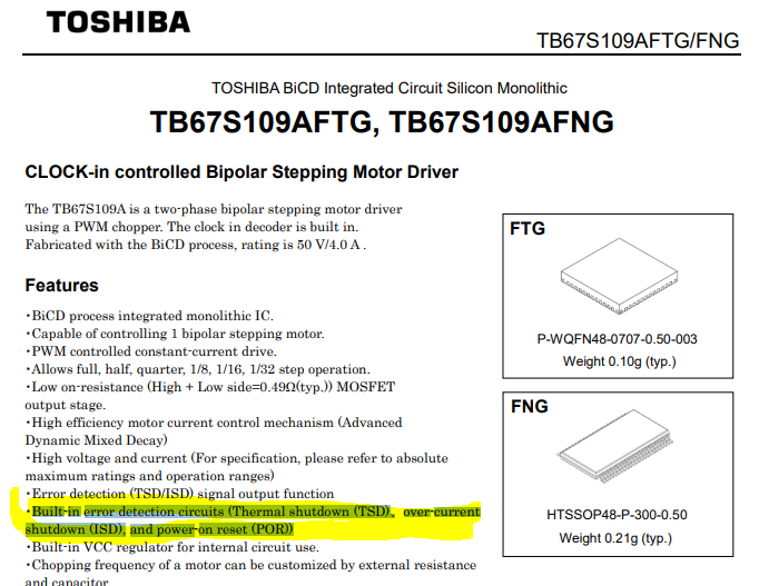

    You are giving the firmware way too much credit here. The FAULT LED is hard wired from the stepper driver chip - you can read all about it in the Stepper driver chip's datasheet (below):
    Firmware has zero control over that, the chip detects faults by itself and shuts down by itself if there any issues. Overcurrent can be caused by incorrect current adjustment, incompatible motors, or short circuits in the wiring. POR is caused by undervoltage. Thermal is overheating
    Possible you changed Step Idle delay from our recommended value of $1=255 Grbl v1.1 Configuration · gnea/grbl Wiki hiding the root cause and it may pop again.
    We recommend $1=255 as it Locks the motors in position while idle. During idle is when motors use more current - so possibly showing the symptoms earlier than if you have it set to something else. Locking then in place mainly maintains position - which is important as it can move while unlocked (Z can drop under gravity even). Don't change anything yet, post that backup so we can review it!
