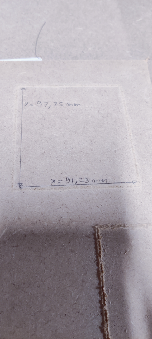

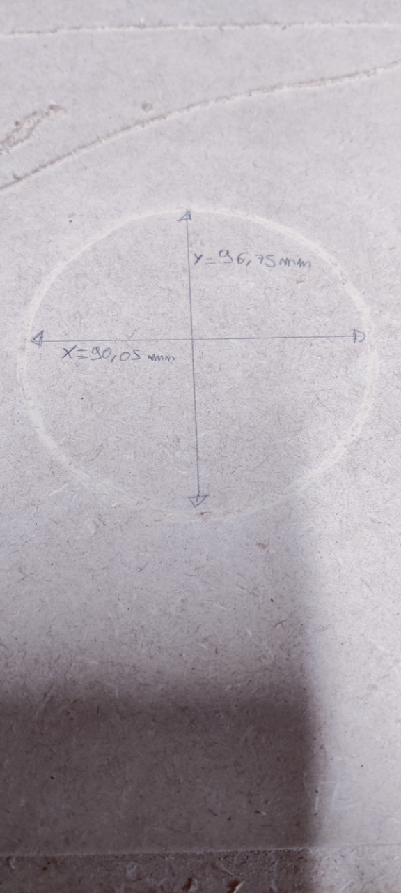

    I'm new to cnc world with a Workbee 1015 (belt driven on X & Y / lead screw on X), Black box (I use OB Cam & Control) and OB xyz probe.
    I finished the assembly and tried to do some cutting test but the result is not as expected.
    I had an issue with precision and I don't know what to correct to solve it (software and/or hardware).
    As you can see on those pictures I just tried to do a 100mm circle and a 100mm square on mdf (I use a 2mm bit) but I can't get the good size and shape.
    Here is what I already checked :
    - Y axes are parallel.
    - I calibrated all the axes with OB calibration wizard (many times).
    - The router is perpendicular "as possible" with the spoilerboard.
    What will be your advices to improve precision ?
    Thank you.

    • Belt tension
    • Grub screws on pulleys / shaft couplers
    • Wheel adjustments
    • Etc

    Thanks for these leads, i will check this and tell you if it gets better.
  4. ArnBee
    ArnBee New
    Nov 10, 2020
    Hello,
    Sorry for the long time reply (health issue).
    It was the grub screw on pulley and fine tune on X axis.
    Thanks.
