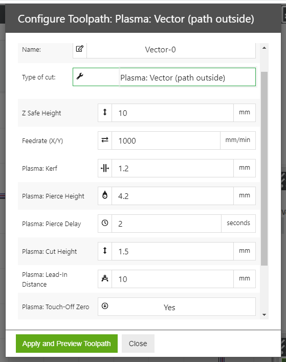

    G64 is not a supported Gcode? (halfway down on gnea/grbl ) You are still not using a Grbl Compatible Post processor.
    You'll need to find a Grbl compatible post, speak to SheetCAM support they may know where to find one.
    If you can do without SheetCAM, OpenBuildsCAM supports Grbl:
