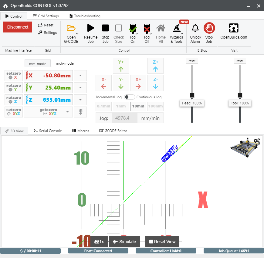

    I'm missing a step in the process I feel. My first project was going to be setting up the underside of the spoil Board. I CADD'ed up the board in Fusion 360, set up just one T-nut hole for a test cut, Installed the OpenbuildsGRBL.cps and pointed the post processor to use it to generate the job.nc file. Now when I open it up in OpenBuildControl the simulate errors with
    No GCODE in Preview yet. Please set up tool Paths and generate GCODE
    What Am I missing?
    Thanks I'm a NOOB at CNC

    Peter recently made a change to the 3d viewer, which may explain the error. Post your job.nc file here and we'll take a look at it. You may have to change the file extension to .txt to attach it to your response.
    It will also be helpful to know where you got your OpenbuildsGRBL.cps file from. I know of 3 different versions on github so be specific.

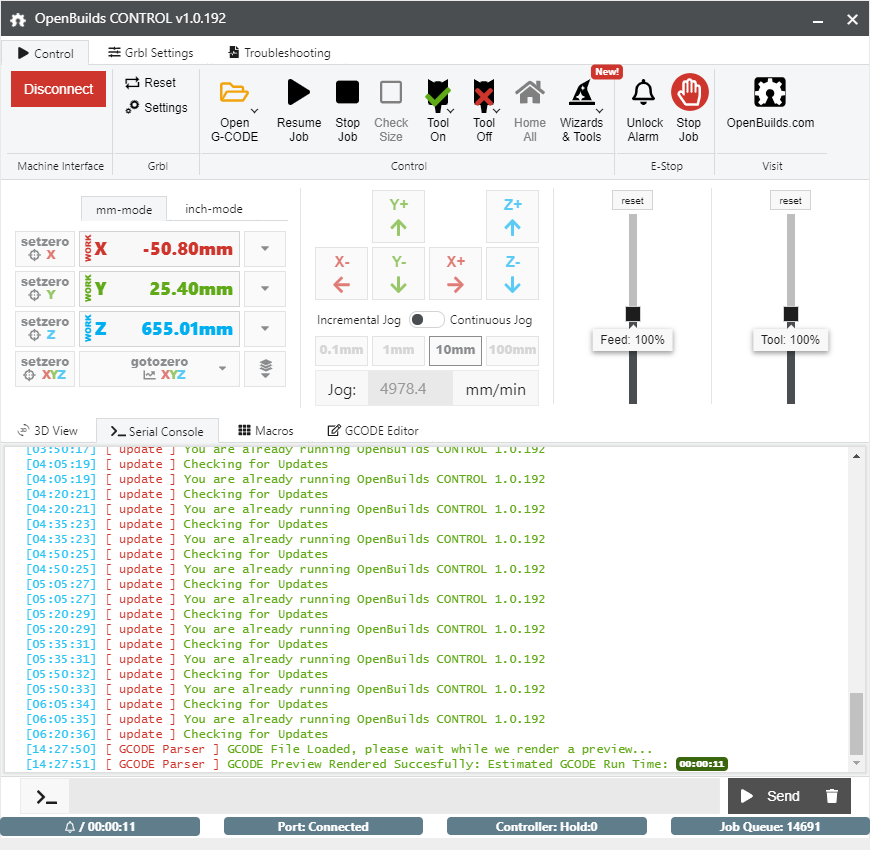

    Yes New to Fusion 360 but have used Inventor 2017> for some time 3d printing. I did generate CAM files with my tool and using 2d adaptive. I figured out that I can run the file.nc and cut.
    New issue just surfaced. I was cutting one-two 2d adaptive pockets at a time trying to dial things in. Suddenly the holes are coming out under size on the diameter. Sill investigating this one

    I did just alow the auto updater run. (installed last week but today is my first day trying to CNC)
    Hole.txt is one of my Fusion360 outputs
    the .cps is from swarfer/GRBL-Post-Processor

    I just upgraded to .194 and the your file loaded fine.
    @Peter Van Der Walt why is the 3D viewer disabled by default?
  10. Peter Van Der Walt
    14,001
    4,113
    Hmm, not supposed to be, will fix in v1.0.195 today

    14,001
    4,113
    Fixed, 1.0.195 should be available in update channels shortly
