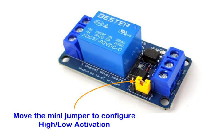

    I recently built a plasma table based on the JD's garage plans. I am controlling the machine with an arduino uno. Everything is operational and ready to go except the plasma trigger relay. It works exactly how you would expect except the trigger is backwards through the arduino. The controller is activating the relay as soon as it connects.
    Is there a way to invert this control that I am missing? I understand there is a normally open and normally closed circuit on the relay, that is not the issue. It is triggered opposite of when it should be.

    Which relay module? Plenty of the cheapies only have Active Low inputs (replace with one that accepts Active High signals).
    Some of the slightly better ones has jumpers you can set

    This was my problem. I was just using an old relay I had purchased and never used years ago and didn't realize the ones they used in the plans had the high/low option.
