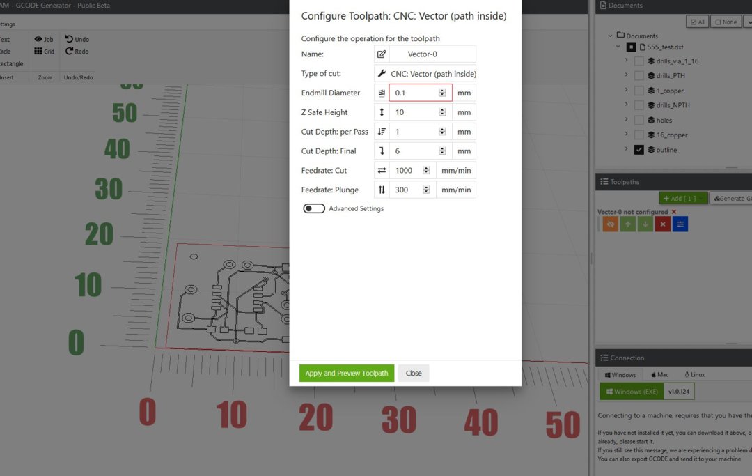

    Hi Guys,
    I am a real newbie at this so please bear with me...
    I am trying to make some PCBs for a project I am working on.
    I drew the pcboard on Solidworks and trying to bring it into the Openbuilds software for milling but it keeps giving me an error about the toolpath.
    The board is pretty small, 6.35mm x 76.5mm so I was thinking that maybe even a 1mm endmill would generate an error so I scaled the drawing up and still get the error so now I'm thinking the error may be coming from the way the DXF file is being generated by Solidworks ??? I also tried to bring in a DRW file but it did not even open.
    Would someone here be kind enough to have a look at the Solidworks file and see why I cannot successfully generate a toolpath for it.
    In case someone would not mind having a look at the file, I attached it with this post.
    Thank you.
    Claude.

    OpenBuilds CAM understands Gerber x274 (PCB format - can be exported from Eagle, Kicad, gEDA etc) - isnt Solidworks for CAD? Using a proper PCB tool will probably work a little better?
    Post the DXF though as David suggested (Or a cam.openbuilds.com workspace export (File -> Save Workspace (Export .OBC File) - If you post the OBC and the DXF I can get a better look of what you were trying to do inside CAM too (The OBC file exports your toolpaths you setup as well, so I can check if any settings you used is an issue)
    If the DXF isnt polylines, try Advanced -> Merge Geometry (When you edit the toolpath)

    Here's my DXF R14 file created with SW.
    I just tried it in OB CAM and gave me the toolpath error and it won't generate the gcode.
    As I said, this board is quite small and I suspect that even the smallest 1 mm endmill is too big for some of the SMD traces I have in there, Is that correct ?
    Here's the two files, I had to zip the obc file because of uploading restrictions.

  8. Peter Van Der Walt
    14,038
    4,122
    Just type in 0.1mm

  10. Peter Van Der Walt
    14,038
    4,122
    It does. Guaranteed. Check around 0m35 on that Christmas tree project (Screencap:)

    I don't know how you can set your endmill diameter to 0.1mm, my only choice starts at 1mm, if I select .1,.5 or anything under 1mm, I get a red box???
    Can you try that with my DXF file and see if it works for you?

  13. Peter Van Der Walt
    14,038
    4,122
    Its red because ".1" is not a number. Type "0.1" you are missing the zero

  14. Peter Van Der Walt
    14,038
    4,122
    Checked your DXF and its not polylines (individual line segments does not constitute a closed vector, nor can it be automatically closed as the segments is not in-order unless its exported as Polyline)
    Export as closed POLYLINES
    What is a polyline: About Polylines | AutoCAD 2016 | Autodesk Knowledge Network
    First google result for "Solidworks export polyline dxf" : Export to DXF with closed polylines | SOLIDWORKS Forums - mentions autocad as inbetween step, but i'll leave that research to you... i don't have Solidworks sorry
    Moral of the story, we need closed vectors to work from. For DXF, that means it has to be proper polylines.

  18. Peter Van Der Walt
    14,038
    4,122
    The issue (Error: creating toolpath) is your DXF, not the endmill setting. As its a bunch of indvidual lines the maths cant figure out what goes where and gives up. It needs to be polylines...
    Ps JustinTime, eagle itself doesnt do gccode, you need a ULP. OpenBuilds CAM Gcode Creator - Public Beta understands gerber x274 though, that you can export from eagle without any extra plugins
    Sidenote, tested and 0.1mm still works... Doest give me red block (ie failed validation). The validate function is very simple; if typeof(value of the input) == a number then its OK, else not.

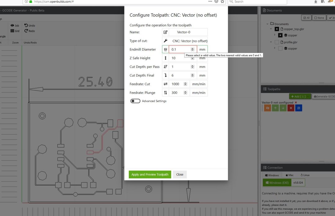

  25. Rob Taylor
    Rob Taylor Master
    Dec 15, 2013
    1,470
    746
    This is a (problematic-slash-incomplete, now I actually look at it, but I wasn't planning on using it anyway) DXF from Eagle, and I still get an error with sub-1mm bits?
    I just Googled and it looks like EAGLE isn't natively exporting polylines anyway (very helpful, Autodesk), so I tried again with the Gerber files, but still nada:
    So I'm not sure. Not that, between Fusion 360 and bCNC, I particularly need to use the OB CAM, but it seems quite nice so having it at least as an option would be cool.
    I guess if you never use offsets and just drive right down the lines, it would be fine, but as soon as tool diameter offsets come into play it's a problem. You could define your traces and pads in-software as the correct size to give you the required offset if you needed to, but it's a problem that shouldn't require solving.
    (Firefox)
  26. Peter Van Der Walt
    14,038
    4,122
    Will test on Firefox today. Chrome does the validation correctly (no surprise, chrome is the best always)
    Thanks for mentioning the browser you use as that makes checking easier.
    Probably same as Firefox: how to show number input value with decimal spaces (sound like firefox not honoring the html standard, again)

  28. Peter Van Der Walt
    14,038
    4,122
    Came in an hour early, fixed the bug... Please test, I think I updated all fields that are Number inputs, but if you stumble on any other place where Firefox throws its toys out, let me know
  29. Rob Taylor
    Rob Taylor Master
    Dec 15, 2013
    1,470
    746
    There's apparently a simple fix I just tried, but I'll go back in and refresh to see your update.
  30. Rob Taylor
    Rob Taylor Master
    Dec 15, 2013
    1,470
    746
    I see it. Yep, that did it. If people are defining their tools more precisely than that, they have bigger problems! :ROFL:
