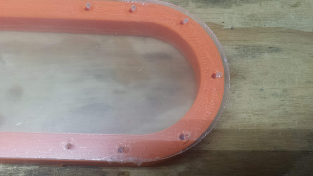

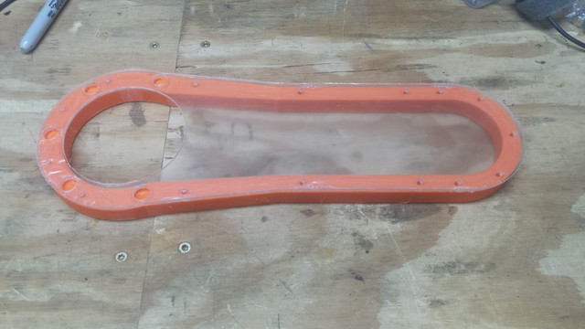

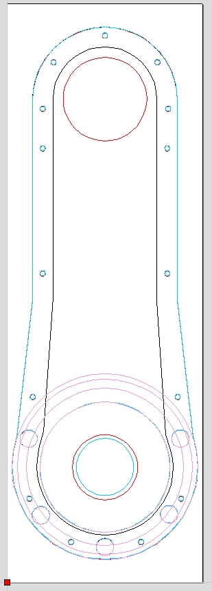

    I created a dust shoe in Vcarve. The top and bottom will be cut from plexiglass and the center body is 3d printed. I took the dxf of the center body from Vcarve into Fusion 360 and modified it into a stl file. The top and bottom that is the exact same dimensions as the center body was cut into the plexi glass. When taking the top and bottom parts cut from plexi glass and placing them onto the 3d printed center body the plexi glass is larger longer in the Y axis than the 3d printed part. I measured the printed part in the Y and it is 326mm and the plexi glass is 328mm. If I measure the 3d printed body in Simplfy3d it matches the 326mm.
    This leads me to believe that perhaps the Y axis is running long for some reason and I am not sure how best to correct it - is it a software issue or mechanical issue?
    I am running Open Builds Black Box using the Open Builds Control to operate the MPCNC. When I first put it all together it was dead accurate in X and Y.
    I just checked the Y axis by doing 100mm marks and it's spot on.

    My first guess is that there are some deflections that are taking place for the forces while the routing is taking place.
    This machine (even though 3d printed) should be able to make these cuts once you find the sweet spot of speed vs force
    A suggestion would be do shallower depth-of-cuts for each pass and take your time.
  5. David the swarfer
    3,408
    1,899
    the tool is rotating and pushing on the material.
    picture it moving in Y + direction. the front of the tool is moving right, thus pushing the tool left.
    it will do this all the way around your part, thus making the part larger than designed.
    if you go the other way around, known as climb cutting, the part will be too small.
    even multimillion dollar machines do this.
    this is why roughing and finishing passes were invented. roughing gets close with fast, heavy cuts (relative to the machine, you are not going to be cutting 2 inches deep in one pass with an MPCNC).
    then the finishing pass, which is very light, will finish to size. a finishing pass may take hours on a 3D part.

    I am using Vcarve to design and then generate the tool paths.
    The cuts made were in 1/8" plexi using a very cheap HQMaster 1/8" End Mill Single Edged Flute (Amazon). These cuts I did at full depth and at a feed rate of 30mm/sec.
    The first photo shows the cuts were spot on at the beginning but as it cut to the furthermost part of Y+ that is where the cut was too long. X axis appeared to be fine.

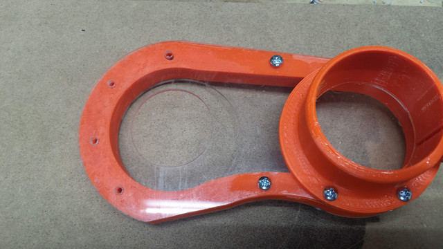

    I am in learning "Grasshopper" mode and turns out the dust shoe design didn't work so I ended up designing another that will work some what but its not ideal but similar to the first.
    The cuts were better this time but still not exact. The orientation was more cutting to the X+ vs. Y+. I also changed the depth of cut to 1.25mm for two passes and I dropped the feed rate back by 25% in Open Builds Control. Makita spindle speed setting was on a 3. My Z height was off a bit so I ran both passes a second time after bringing the Z down a couple of thou.
    I would like to understand what can I be doing to ensure the best possible cut.... I.e. what is missing from my workflow (roughing / finishing pass - set up in Vcarve?)
