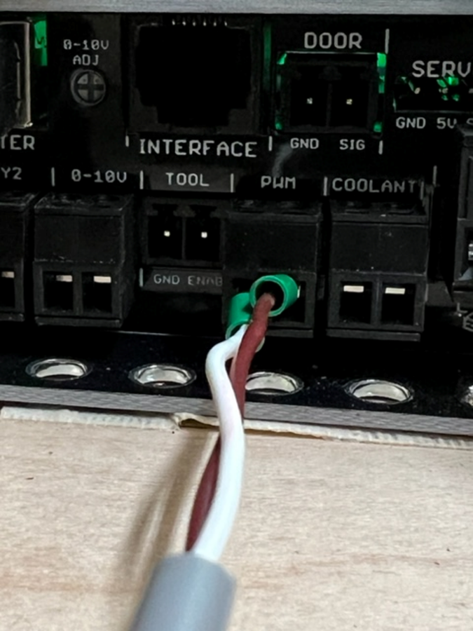

    Good morning,
    I have the Opt laser installed. I also have the X32 Blackbox. The laser is on but won't fire in run mode. My question is what terminal do I connect to on the X32 black box?
    13,992
    4,107
    The PWM terminal. Refer to docs.openbuilds.com/blackbox to learn more.
    Make sure you enabled Laser Mode in Grbl Settings and test using the Tool On menu in CONTROL
  7. Michaei
    Michaei New
    Oct 5, 2018
    25
    I plugged into the PWM as the documents said. I also enabled line $32 laser-mode enable, Boolean. The laser still won't fire in run mode. Any help would be appreciated..

    Post a backup of your Grbl Settings for review (CONTROL > Grbl Settings tab > Backup Settings button on the main toolbar)
    If its not that, its wiring - so post pics of your laser wiring too.

    Photo of the laser connected to the blackbox. Thjere are only two wires.

    All the wiring. Laser side, psu, etc. We want to help you look for possible wiring mistakes

    Thanks, but they seem to have been scaled down in resolution, - hard to help you check wiring. Seems the white/brown out of the PWM plug goes into the right side of the Opt Lasers CNC Adapter.
    1) Docking Station wired correctly?
    • Sure its on the right terminals, correct polarity etc?
    • Does the Armed LED on the Optlaser CNC adapter light up? In the photos none of the LEDs are lit.
    • Does the Laser LED light up when you send a Laser On from CONTROL?
    • Looking at the docs, it skips an output pin. PWM and GND have an Enable in between. Hard to see from the low-res photos you provided, but make sure yours matches as from here they look almost next to each other?
    They should be like this:
    2) BlackBox side checks
    • Any earlier miswirings that could have damaged the PWM port?
    • Does the PWM LED on the front of the BlackBox scale correctly when setting various power levels in CONTROL > Tool On > Laser > Various power level options. At 100% the PWM LED on the front should be brightest

    Peter, Lights on, wired correctly.

    That does indicate the PWM port on the BlackBox works, and the PWM signal is being generated (Correct commands sent from CONTROL, correct S-values read from Grbl Settings) - sadly that does put the issue beyond the BlackBox.
    That PWM LED is in parallel across the terminal - so if it lights up we are sending the signal.
    Jumpers and wiring looks good.
    Its either
    • not getting to the CNC adapter (wiring, but it LOOKS perfect) - can verify with a multimeter that its getting to the other end - should see 3.3v at 100% power
    • is getting to CNC adapter but its Enable settings is wrong preventing it from "enabling" (Page 18-21 of CNC adapter manual
  25. Michaei
    Michaei New
    Oct 5, 2018
    25
    Peter,
    Thank you so much for all your help. The laser is now working. I had to do the enable step. Thank you again for listening and sticking to it until the issue was resolved.
