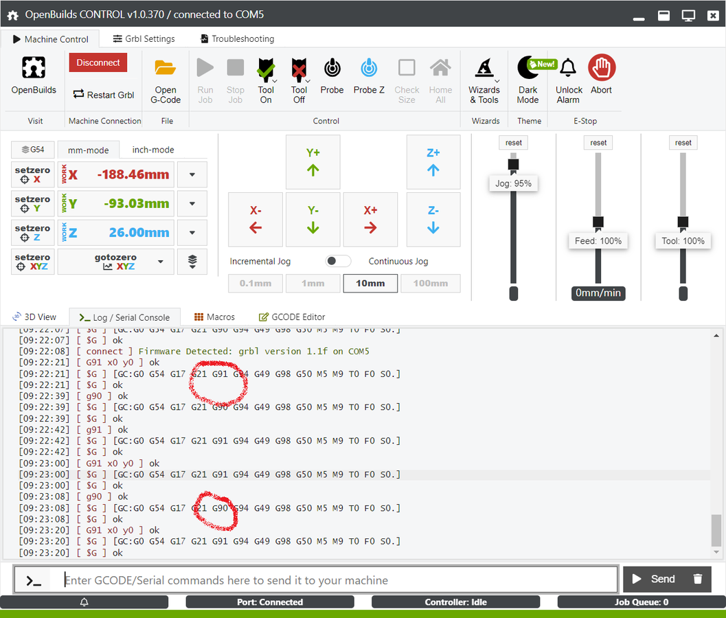

    To whom it may concern:
    This morning after weeks of operation, I had strange behaviour occur.
    I would be sending G-code commands in this particular case G1 Z-0.05 F7. It would move once and then when I would repeat it, it would not move.
    I then tried to jog the Z-axis back and forward with 0.1 mm and that worked. So it is not the stepper motor (I do not believe).
    I could not see what was happening. The X and Y-axes seemed to work as they should.
    I then went into the firmware flashing tool and used the settings/options as seen in the attachment. I managed to re-load backed up settings I had but I will re-calibrate the axes.
    Was this the correct thing to do?
    It appears to be working again.
    Not sure what may of happened?
    Could you tell me what other tests I should run to make sure the board is not damaged and/or the stepper motors?

    It sounds like you were expecting incremental moves - If you were in absolute mode, that behaviour would be correct.
    Incremental mode is set by sending the G-code command G91
    Absolute mode is set by sending the G-code command G90
    Once set, the mode will stay the same until changed (e.g. by running a program).
    (It's always good practice to set the mode for the behaviour you expect before sending other commands - also metric / inch mode G20 / G21)
    Could that be it?

    I had been typing in the command G91 X0 Y0 Z0 before any other commands.
    That would put it into incremental mode, if I am not mistaken or how would the G-code look?

    That should put it in incremental mode (G91). That actual command doesn't do anything else though - You could just send G91 on a line of its own.
    You can tell what mode the controller is currently in by examining the status that it returns after executing a command:
    If the machine is still on, you could scroll back through the messages to see what was happening.

    Hi Misterg,
    You were right in your thoughts upon investigations.
