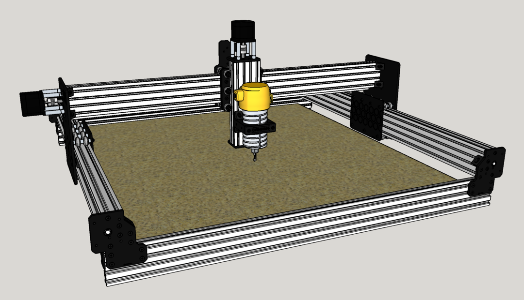

    I'm interested in building the 1010 Workbee. Starting with a 3d-printed cnc this year (TopsCNC - The new 3D printed CNC Router Version by Topsie) I realized I want more and better aluminium milling. I'm planning to source the parts myself as I already have a bunch lying around and I'm on a tight budget.
    I would like to ask, if you really need 1040mm leadscrews on the 1010 machine or are 1000mm enough by chance? 1040mm leadscrews are much more expensive to source then 1000mm leadscrews. Or do I just have to order the extrusions with 40mm less length and everything should be fine?
    Thank you very much for your inputs :)
    Michael
  6. JustinTime
    JustinTime Veteran
    Dec 18, 2013
    759
    253
    The length of the lead screw will determine the effective cutting length you will end up having. The longer the screw the longer the cutting length. You could use 500mm if you want, it would make no difference to the build of the machine. So the answer to your question is, yes, you can use 1000mm screw. The extrusion can stay the same length that you already have or, if you don't have it yet, order it shorter.
  7. Peter Van Der Walt
    14,002
    4,113
    The extrusion has to be 40mm less than the leadscrew length - to allow one end of the leadscrew to seat in the idler bearing, and the other end to go through the other idler bearing, plate, and protrude enough to also go into the Shaft coupler to connect to the motor.
    If both are the same length, you will have trouble fitting it

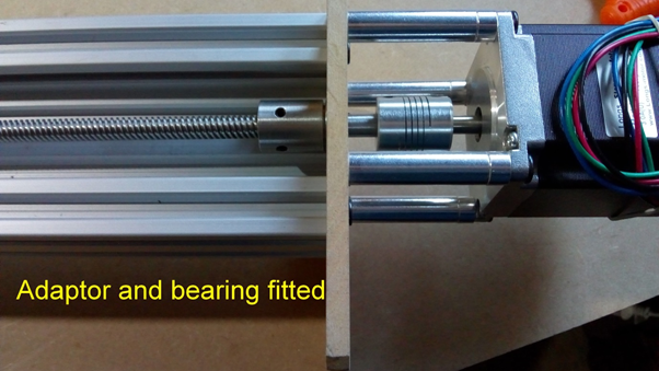

    Sacrificing 40mm of the Y axis might not seem much, but it's better to have the extra than to not have it - bigger is always better for CNC routers
    I had the same problem during my build and was about to munch 40mm off my Y axis C-beams but decided to sleep on it - I had some 1000mm screws in the shed and was keen to repurpose them. After 15 hours in bed I finally came up with the idea of using adaptors to effectively lengthen the leadscrews. The problem of course is that you would need the resources to make them but easy if you have access to a lathe.
