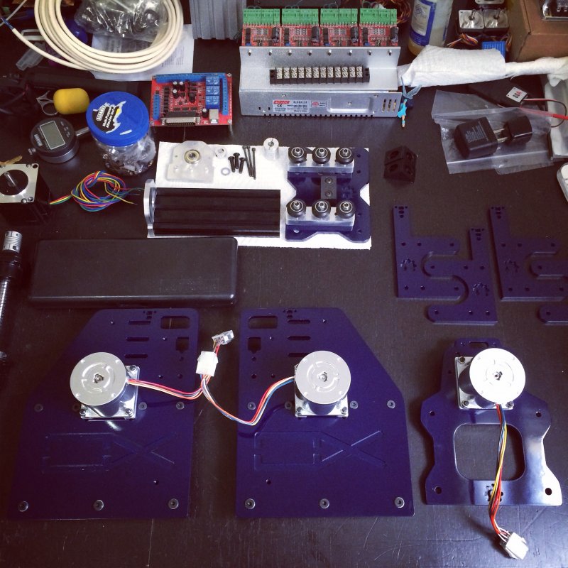

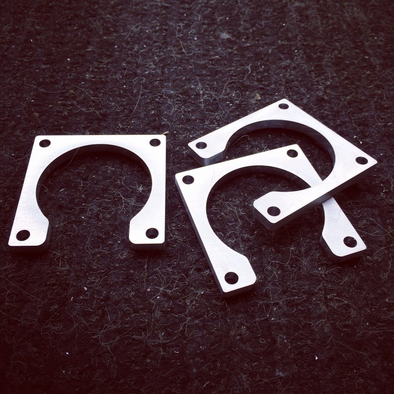

    Little update :)
    Motor spacers milled from 6061
    Motors mounted with spacers in place :)

    I believe I just blown my driver board. I was try moving the axis and when I try the z axis just see something short and a burn smell. Anyone know which board I can use to work with my OX. Also any help how can I verify the openbuild motor if still work.
    Thanks in advance,
    Alberto

    Looking great so far Robert! :thumbsup:
    Any specs on the drivers you have there?
    Thanks in advance
    Mark
    Alberto Boria likes this.
  25. Robert Hummel
    Robert Hummel Custom Builder
    Moderator
    Nov 14, 2013
    978
    714
    They are TB6600 4.5 amp drivers from china.
    They work fine but I was not happy with the layout.
    I have since found much better boards, same driver and will be offering 4 driver kits soon.
    My first batch sold out really quick

    Hi Robert.
    Please can you keep me posted on these new 4.5Amp Drivers kits you plan to market?
    If they are not too expensive, maybe a 5 Drivers set could be handy for future proofing.
    Do you plan to supply them mounted to a heat shield etc, maybe too much weight there, or in a box of some sort?
    I would be running them with the USB/Controller.
    What are those motors you have attached to your boards? I don't recognise them?
    (I reckon you must dread putting up a picture on the Forum, because you immediately get bombarded with questions!!)
    Many Thanks
    Gray
  30. Dave Millard
    May 26, 2014
    27
    Hi Robert
    Do these spacers make any difference to the stability of the Z motor versus using normal alu tube spacers. As it sits directly above the screw, and the screw sits between bearings at either end, the twisting moment cannot be that great. Is this just a personal style preference.
    They look really nice, btw.
