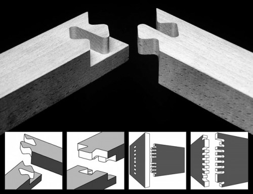

    Greetings all,
    I just ordered the parts for a modified 1500x1000 OX build. Currently unemployed IT guy, so I am going to learn the CNC thing. I am into wood and metal, so this should be fun.
    I am building the work surface to include a removable plug to be able to cut the ends of things like this: http://www.youtube.com/watch?v=Y6MnVHmr2UY
    Since I have many computer cases laying around, I plan to convert a case to use one of these:
    http://www.spark-concepts.com/cnc-xpro-controller
    When stuff comes in, I will start a build.
    Digger
