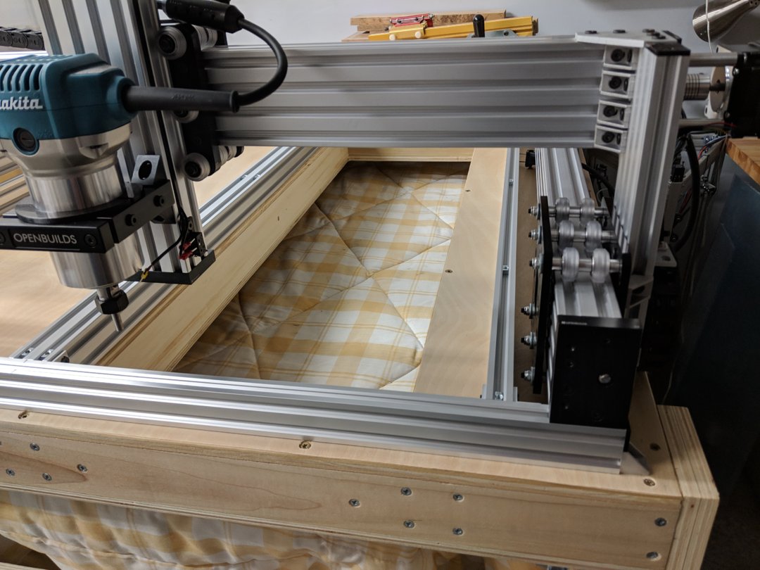

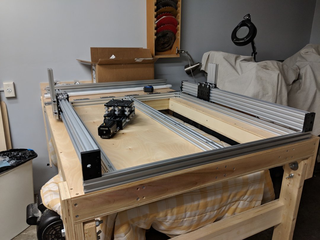

    Day 31 - All Is Lost:
    The seas froth and bubble, as if they wish to wrap us in their lethal embrace. The mast is broken, the sails are in ruins, the ship is a junk. The hull split wide, as if opened by the builders. The captain has gone mad, muttering endlessly about "sea and sea". A sudden shout is heard over the tempest - "BAT OVERBOARD!"
    You guys don't mess around when it comes to packing, do you?
    Looks like it paid off... everything on the packing list is there (I checked. yup, every screw. every. last. ***** ** ***ing ****. screw. couldn't you have swapped out some of the self-tapping screws with self-counting screws? tapping is easy), but I didn't think to cross-check against the BOM, which is what actually matters. Oops. One thing that would've made the process a little easier would be including the name or SKU of the parts on the bag - there were a few things I had to look up on the site to identify.
    The wrench & the driver set don't show up on the list, but made it into the box anyhow. The rather nice looking "Made in USA" driver set, even. I didn't know there were metric drivers being made domestically. You don't mention that part on the store page, either.
    The finish on the rails did get a few scuffs and scratches already, though (some in transit, some because I'm clumsy) - one of the reasons I was having second thoughts about ordering the black version. Of course, those scuffs and scratches will soon be covered over by the scrapes and gouges of reckless use and/or collisions with wandering machine tools. Luckily the lighting's poor in the basement.
    On the whole, though, everything looks great... I'm sorely tempted to forego sleep and start building right now.

    So I'm thinking of going the T-Slot waste board route this time. While looking at the 20x40 stiffeners on the bottom that run along y-axis it will become more challenging to add t-slots and MDF in combination while maximizing the available Z-axis height.
    Any suggestions?

    My thought was to mill slots into the wasteboard, and then lay in some T-track like these [ https://www.amazon.com/POWERTEC-71118-Double-Cut-Universal-Predrilled/dp/B074MN2CPL ]. I imagine it would also be possible to use 20x20 V-slot, but you'd have to have a pretty thick wasteboard.
    Another option - which I used on my last machine - was to drill a 1" grid of holes into the wasteboard for threaded inserts [ https://www.amazon.com/Z-Threaded-Hex-Flanged-Internal-Threads/dp/B002KT43MU/ - the $7 pack, not the $90 one - yikes! ] and then make Inventables-style clamps [ Clamp Set ] with various-length arms that screwed on. It's not something I'd recommend if T-track is an option, since it's more work and not nearly as versatile, but it's a viable alternative if you've sunk all your money into other parts & come up short on cash*. They also make a smaller target to hit when you send your tool cruising through the wasteboard, and are cheaper to replace. Not that I've ever done anything like that... this week.
    -Bats
    * in other words, it's probably what I'm going to end up doing yet again, at least for the first month or so.

    I've made a tweak to my build to support a split wasteboard. I built a flip-up torsion box to float over my table saw (space constraints). I left a large opening in the torsion box and exchanged the center 20x40 extrusion with a 40x40. The intent is to be able to roll the table saw out from underneath and route the long end of parts, etc. The opening in the torsion box will be used for fixturing location etc. It also gives me room for a 4th axis and vices as well.
    I placed t-nuts on the top sides to allow easy removal of the waste board,

    So basically the torsion box bed lies down flat on top of the table saw surface but flips up when there is a need to use the table saw. Need to see more photos of the setup. I have a few initial concerns about maintaining square over time but maybe you've already accounted for this the design.

    The box itself is quite rigid and for the most part 100% glue on all joining and laminated surfaces with screws added. I can't detect any flex and it's dead flat using a 4' level as a reference. May have gone overkill on hinges, but I wanted to be safe as use in a horizontal orientation is not ideal for loads.
    It sets 24" off the wall and is secured with a french cleat with a strip across the back side to secure it.
    All-in all, I'm quite happy with the end result. With a bit of luck, I'll have a dust boot ready and a 2nd stage bucket for the shop vac to begin surfacing the waste board and placing holes for threaded inserts..
