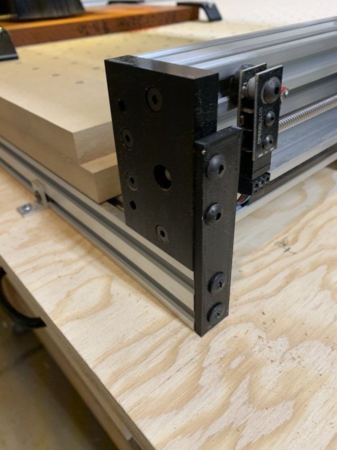

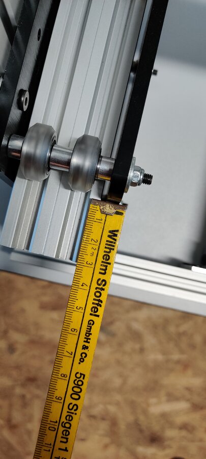

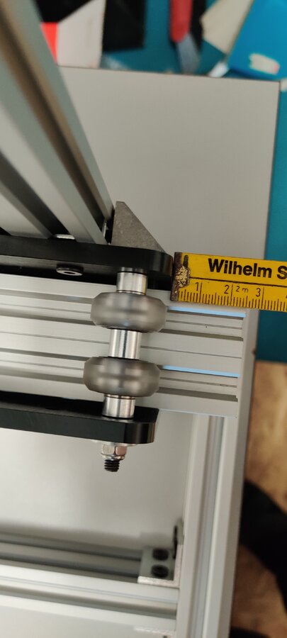

    Hey guys! Started to build my lead 100x100 cm machine. Getting to the end of the build but Ive encountered this issue today. The gantries moving on the Y axis doesnt seem to hit the end at the same time.
    The gantry on the left c-beam could still go 5mm till hitting the corner brackets, while the right gantry hits it already, while the machine has an opposite issue when going to the back, the left gantry hits the end of the c-beam while the right one could still go those 5mm.
    I started to think there might be issues with the machine not being square, but Ive checked that with a 50cm square and both the base, and the C-beams seem to be square with each other. Measured all the beams for any errors with cutting but they also seem to be perfectly even.
    Any idea what could be the reason for this? Is it actually an issue or it will disappear when I mount the Y-axis lead screws?

    Measure corner to corner with a tape measure. If they both match, you are square. I bet one will be longer. I have a square that, well, is almost perfectly square. But it isn't perfectly square. Actually none of my framing squares are "perfect" either. Unless your square cost a fortune, it may not be either.
