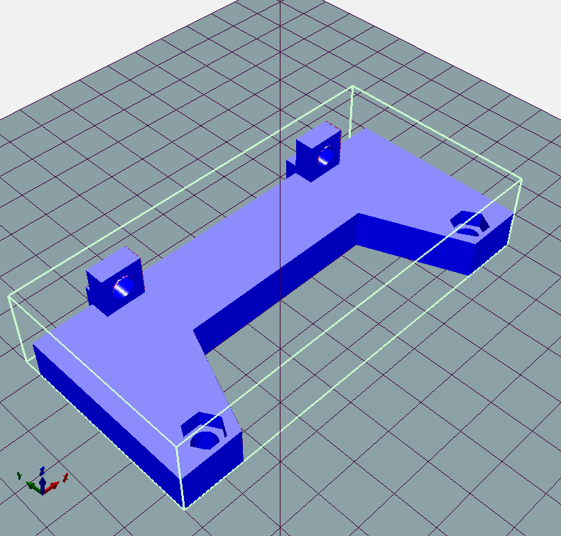

    Just printing version 2 - version 1 didn't quite work.

  4. Alex Chambers
    2,700
    1,327
    No - a plate that clamps to the Z axis C-beam with screws passing through it to press on the underside of the router mount.
    A bit like this (if it works)

    Wouldnt that square it up with the rail, instead of the bed? (You want to tram to bed)
  6. Alex Chambers
    2,700
    1,327
    The idea is to hold the router mount in position while you tighten the fixing screws after you have trammed it. And possibly provide a micro-adjustment while tramming.

  8. Alex Chambers
    2,700
    1,327
    If it works I suspect an aluminium version might be more durable!

  13. Alex Chambers
    2,700
    1,327
    Correct (as always) - my gadget is only for the final check on the router mount to Z axis alignment as I couldn't see how - on the workbee - you could accurately adjust this bit without at least three hands!
    Alex.:D:D

  20. Alex Chambers
    2,700
    1,327
    Concept worked - gadget didn't work well enough - plastic not rigid enough.
