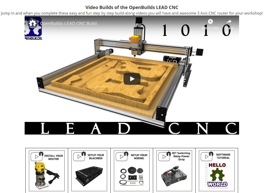

    Hey guys quick LEAD Build update:
    Thanks to the hard work of the OpenBuilds Team - The videos in the build section have been updated to now reflect the BlackBox wiring! :thumbsup:
    All the videos related to the Build in that section have been cleaned up and look really sharp and are easy to use now.
    Hope this helps, Thank you
    Mark
