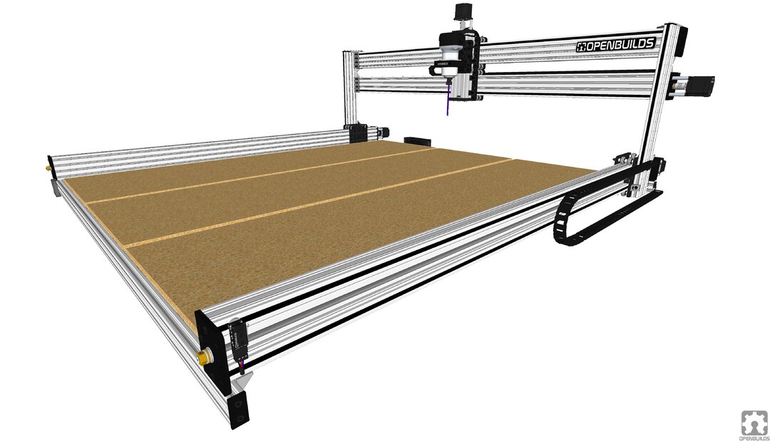

    Hi! I'm new to all this, and I have built a Lead 1515 using parts I already had and purchasing the ones I didn't. I have a question regarding the posibility of working on a full half sheet of plywood. How could I do that if the working area on the X axis is only 1170mm and the sheet of plywood is 1220mm? How could I use for example the xyz probe plus with this?. Thank you so much. Im currently wiring all, I will use a blackbox of course. Thanks!
  5. Giarc
    2,919
    1,619
    First you need to figure out what space you loose no matter what you try.
    125 mm for the x gantry.
    40mm x 2 for the y axis cbeams.
    At minimum, 20 mm x 2 for the angled blocks that assist in joining the x axis to the uprights of the y.
    Another 20mm x 2 for those uprights
    So, 125+80+40+40 = 285
    That leaves you with 1215mm
    However, I do not have a Lead 1515 in front of me so there may be other things that reduce the area.

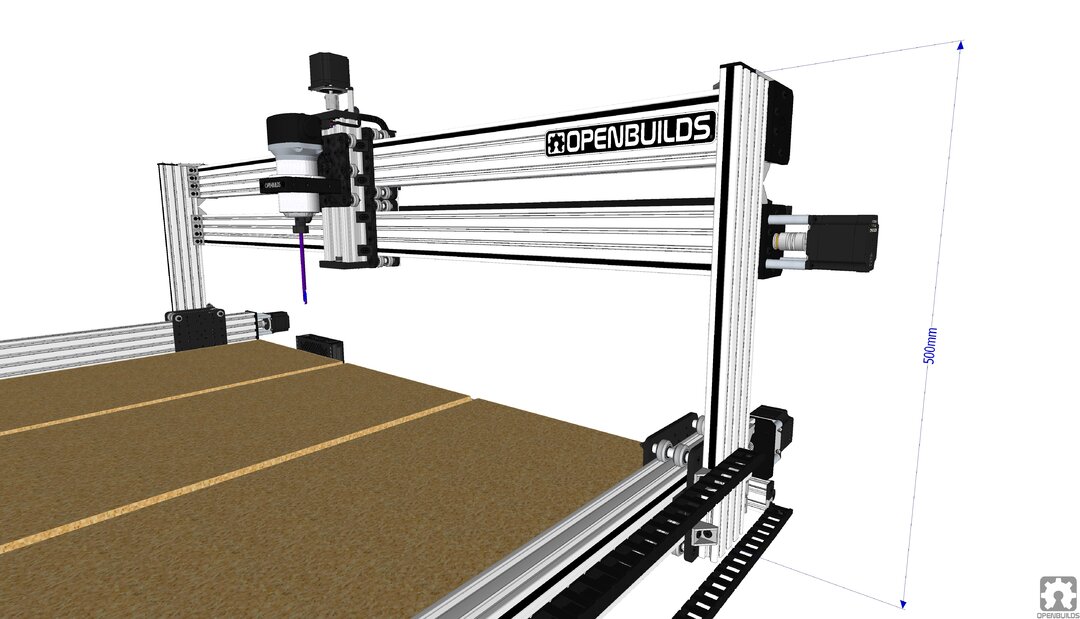

    Hi All,
    Does anyone know the maximum recommended spindle weight and size for it open bills 1515 lead machine?
  21. Peter Van Der Walt
    14,024
    4,117
    We recommend the RoutER11 CNC Kit or DeWALT DWP611 Compact Router from our store. If you have to use a VFD based spindle, the 0.8kw/1,5kw 65mm small-body spindles are a good bet. See How to calculate V-Slot® deflection - heavier spindles cause deflection and for high horse power spindles, you also have to resist the cutting forces to prevent chatter
