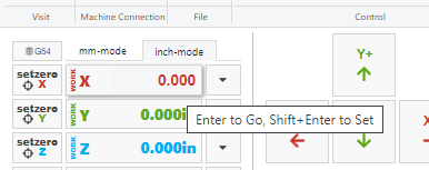

    You can jog to specific positions one axis at a time - just type the position you want into the appropriate [X, Y or Z] DRO box and when you press enter the machine moves there. (I use it regularly).

    Yes, CONTROL already has it (though I'd like the alternate, type in a number and press enter to have that axis set to that offset, thus shifting the WCS 0)
  12. Peter Van Der Walt
    14,038
    4,122
    Not this one?
    Enter to go to entered value, Shift+Enter to set current position as the entered value?
    Misterg likes this.
  13. David the swarfer
    3,287
    1,837
    perfect!
