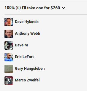

    I pulled together some pricing, stateside, PA. I can get the set produced for ~260 (+shipping. +26$ to cover paypal fees) per set (ordering 5+ at a time). I'm looking into shipping now, Peter, now that you have a put together enclosure what did the outside dimensions come out to?
    That said, that pricing needs 5+sets ordered. Which I don't think would be too difficult to achieve.

    PS: We have 6 parties on Google Plus confirming they want - so that target of 5 looks to be reached:
