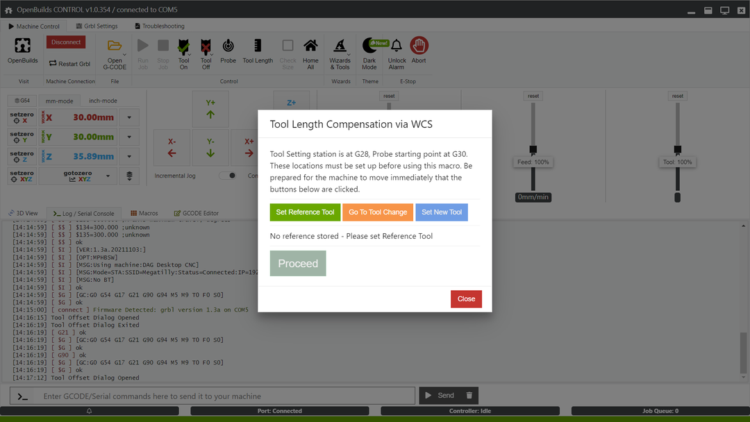

    If you skip to the 10 minute mark, the automatic Z height offset is the main thing I’d love to see in Control. My parts operations usually require 2 - 4 tool changes and not having to re-probe the z height would be an amazing quality of life improvement.
  3. Giarc
    2,915
    1,619
    But isn't that essentially re-probing the z height? I was going to add one to my machine, but realized it would take longer to have the machine travel to the location the permanent offset was than to just re-probe above my XYZ zero point where I change tools. However, I am only looking at it from the speed and accuracy aspects that I prefer. There may be something I am missing. Obviously this would be great if the machine did automatic tool changes.
    dJOS_500 likes this.
    13,991
    4,107
    So, basically just the great Misterg's TLO Macro? : see post #14 in Getting started with Javascript Macros in CONTROL / Library of Macros created by the community
    Macros for the win (again) - deals with it in a way that's more forgiving than grbl's builtin TLO which was sometimes a bit flaky

    Sounds similar to what I do - Little snippet of the macro in operation at about 1:30
    1) Set reference tool
    2) Move to tool change location (and manually change the tool)
    3) Set new tool
    4) Return to starting position at ~1:38

    it’s actually your macro that Peter referred me to. I’ll check out your video.
