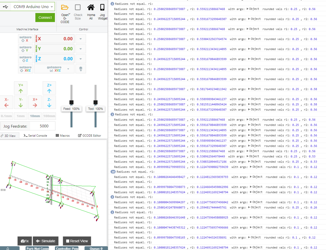

    Post your GCODE as well, that error comes from Grbl not liking the G2/3 gcode format used

    ho hum, my post has failed for your case of using a 1mm bit for those tiny slots.
    If you send me your fusion file I will try to solve it but meantime you can turn off all arc usage (an option in the post, I don't have fusion here at work so cannot point it out exactly) so the post only generates G1 moves and you will be able to get your parts cut.
    The display in bCNC shows that for that slot it is actually trying to cut more of square with the straight edge displaced compared to the other slots, and because the end of the straight edge is misplaced the arc radii are incorrect. Very strange indeed.
