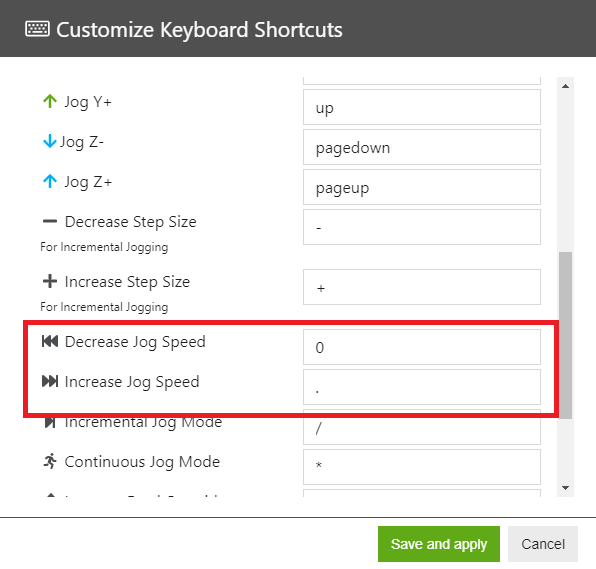

    Is there any shortcut keys to select like 25%, 50%, 75%, 100% jog speed when hooked up with the computer and OB control software? The slider is cool, but kind of a pain also to have to work with on a laptop and touch pad.

    10% up and down by ("0" and "." = bottom row of numpad by default, customize to whatever you want)
    Implemented in v1.0.298
    JStewieDesigns and sharmstr like this.

    See Wizards and Tools > Keyboard Shortcuts
    We offer only 10% increments. 1% in imperceivably small
