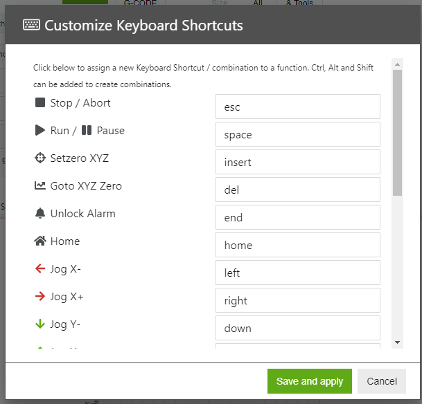

    Hello,
    I've got a ps3 game pad that I've mapped to key strokes using antimicro. I can move the stepper motors, move the pen up/down, turn the laser on/off. But i'd like it to do more.
    I'd like to be able to press buttons on the game pad to Run Job, Cancel, etc. What are the commands to do these that I could put into a macro?
    Also, is there a list somewhere with all of the default hot keys used in openbuilds Control? So far I've just gone through the keyboard pushing buttons one at a time and seeing what happens.
    Thanks,
    Wolfgang
  18. Peter Van Der Walt
    14,034
    4,120
    Wizards and Tools > Customize Keyboard Shortcuts
    Defaults (you can change to whatever you want it to be)
    Run = space
    Cancel = esc
