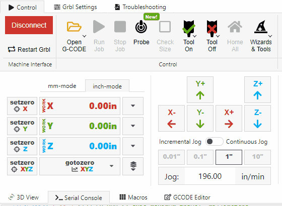

    Weird. 1 mm equals .04 ( actually .03937) inches. Are your settings right and saved before restarting? Let me go out and play with mine to see if I can replicate it.

    I just downloaded the latest version before this happened. Is there a bug?

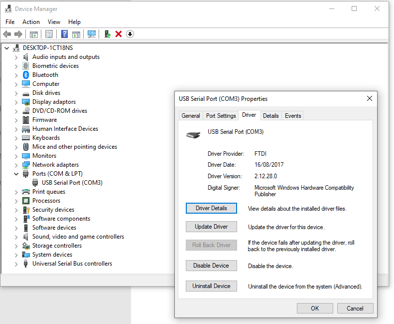

    Hi Mark,
    I had an issue today connecting my black box controller to my window 10 computer, see attached error message. I have had no problem in connecting to this computer and a laptop in the past, and have run my machine no problem before today. I have tried removing the open builds software and reinstalling. I have noted I can not find my GRBL settings to add my lead machine 1510.
    It is obvious that I am doing something wrong. The black box is running okay and I have power to the USB connection.
    Hope you can guide me through this problem
    Regards, Mark
    See my USB port COM 3 Settings. I have noted when the power supply and the black box is powered off, I note the green connection light is no longer illuminated.

    try
    different cable
    different usb socket

    I can't replicate:
    1 i start CONTROL, connect to Grbl 1.1 on a BlackBox
    2 switch to Inch Mode
    3 click the 1" increment
    4 Click jog buttons, moves 1" (machine is calibrated) and DRO shows 1 inch of movement.
    What are you doing differently?
    PS your screenshots shows 0.000 not 0.04? in your post above at OpenBuilds CONTROL Software
    #1539 Peter Van Der Walt, Oct 16, 2020
  10. jamin35008
    jamin35008 Well-Known
    Feb 7, 2019
    136
    44
    I was just showing where I was seeing the .04 in the DRO
    Steps 1-4 are exactly what I was doing.
    I went into my GRBL settings and noticed the "Lead 1010" settings were no longer selected in the drop down and instead set to the "custom machine" settings. I re-enabled the Lead 1010 and now the DRO is showing 1" traveled when the 1" increment is selected.

  11. Mark Tollitt
    Aug 20, 2020
    I have checked my USB Com 3 Port and it says it is working properly - see attached.
    I have checked all of my wiring and connections and all connected correctly. Note no USB connection light on the black box, changed USB cable, same issue.
    What is PORT INFO: Port closed?
    Perhaps the black box is faulty, have you had issues with the BB similar to this problem before? I have had the machine working perfectly before yesterday.
    I just connected to my old laptop that I used to set up my original software and connections, same issue and error messages. It seem that the USB connection at the serial in to the black box is faulty. There should be a connection green light on at the BB even if the black box and power supply is switched off. I am not going to pull the BB apart, as to avoid warranty. Are you able to send me a replacement unit and I will return this one back to you? This is a inconvenience as I wanted to run my first couple of jobs this weekend.

  12. Peter Van Der Walt
    14,039
    4,123
    Refer to docs:blackbox:faq-usb-connection-faile [OpenBuilds Documentation]
    In particular, note the Last paragraph: if the steps in 6.3.1 to 6.3.5 does not resolve the issue, then, as per 6.3.6, contact the Store for a warranty process. The Forum cannot help with that. See

  16. Mark Tollitt
    Aug 20, 2020
    Hi Peter, I contacted the Open Builds store regarding the issue with my black box, they have not responded to my surprise. I am unsure what to do next?
    I contacted one of your suppliers/agents based in Melbourne - Carrum Downs - Maker Store. They have asked me to send them the screen shots of errors to see if they can help me. I am a little frustrated at the moment as I have completed my project and can not use the equipment.
  17. Peter Van Der Walt
    14,039
    4,123
    Check your spam folder, and try sending another email. They will get back to you once they have worked through your issue.
