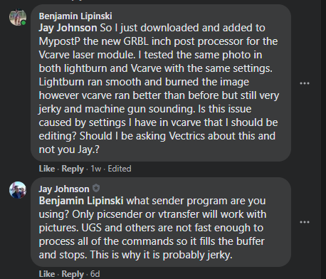

    So I was using a photo I have of my two daughters and trying to get the settings correct to laser the image on wood. I was using lightburn at first but also wanted to upload the image to Vcarve and try it in the their new laser module. I saved my work using the JTech post processor used with GRBL and loaded that into the Openbuilds control. When I was running the burn I noticed that the laser was much more intermittent almost like it was buffering as compared to lightburn which was very smooth running. The difference was a 30 min burn using lightburn and what would have been close to 2 hours using the Vcarve/Openbuilds control.
    Is what Jay Johnson says below true? Should I be using another control to send pictures to the laser like Picsender or Vtransfer when using Vcarve? I really don't want to learn another program to use. I really like the Openbuilds control.

    My confusion comes from why Lightburn is running smooth and with no issues but same file is causing the Openbuilds Control to bog down and run slow? Both programs are being ran from the same PC.
  15. David the swarfer
    3,278
    1,835
    if you post both Gcode files here maybe we can see what is diffreent

    So I have uploaded the two Gcode files. I decided to run a test between Lightburn and Vcarve/Openbuilds Control.
    In the test I ran the same photo through both Lightburn and the Openbuilds Control at 70ipm/45% power. Lightburn ran very smooth and finished the file in 12:38. I then applied the same perameters with Vcarve and used the JTECH PP to save the Gcode and then opened it in the Openbuilds control where it was so intermittent that I quit the burn after a few minutes. It would have taken a long time to complete.
    I then decided to open the Gcode saved from Vcarve in Lightburn and see if it would have the same intermittent characteristics it had with the Openbuild Control but was very smooth just like as if it was created in Lightburn. The file took 13:18 to complete.
    I then took the Gcode I created in Lightburn and opened it in the Openbuilds Control to see if it would run smooth but it ran very intermittent again.
    Is there to much for the Openbuilds Control to process when it comes to engraving photos or images? From this test it seems that if I create a project in Vcarve that includes a image or photo I should load it into lightburn and use that as the sender.
    I have uploaded a video of the laser. The first 30 seconds or so are of the Openbuilds Control and the last 30 seconds or so are Lightburn.
  20. Peter Van Der Walt
    14,001
    4,113
    The GCODE from your v-carve file violates the best practice for Grbl 1.1 Laser Gcode (with Laser Mode $32)
    NB NB NB Have a read through gnea/grbl and then find a Grbl 1.1 compatible Post
    Laser Off moves should just be G0
    The output below is Grbl 0.9 style with the laser on/off commands repeated all the time with a G1 used as the off move, its just wrong

    I'm hung up on why Lightburn can process the file with no interference but the Openbuilds Control is struggling? I'm running both with the same computer.
  25. Peter Van Der Walt
    14,001
    4,113
    Different architectures (control does a lot more)
    As that PC doesnt have a fast enough CPU things go laggy.

    the big difference between the files is that the Vcarve one is FULL of M4/M5 pairs where as lightburn does not have that.
    The way that GRBL implements laser mode means that these separate poweron/power off codes are not needed for every line, they just slow everything down since they cause an actual motion stop at the end of the line segment.
    I suspect lightburn is filtering them out and this is what makes it so smooth.
    As a test you can open the vcarve file and search/replace all M4's and M5's with a blank, then place an M4 at the start (line 8) and an M5 at the end (just before the M2) and run that through CONTROL.
    EDIT: Peter is right, this won't work because it has G1 moves between the power cycles. Ergo, that post is just wrong for GRBL's laser mode. Do tell JTech to read the GRBL wiki (-:
