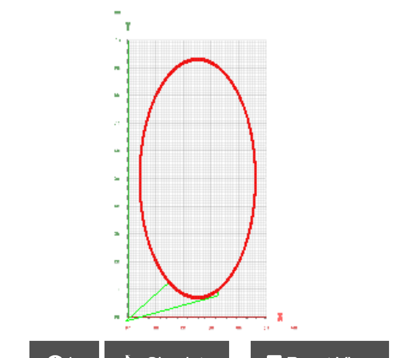

    If I may, I would like to know why after creating my work in Vcarve_pro and sending it to the OpenBuilds Control Software the placement is way off.
    I do an initial Check Size but my work never centers on the Work Piece, It is not even getting the size of the piece of wood I want to cut right.
    Could you assist please?
    I am using the the same inch or metric rule through out so I am puzzled.
    Thank you,
    Randy

    1) Is your steps per mm set correctly?
    2) is your origin point in Vectric, the same as where you SetZero'd the origin in reality? (bottom left corner, center, etc)
    3) Did you remember to SetZero?

    So here is what is happening. I am making a house sign. I saved the numbers and the outline cut out as separate files. It is Creating the correct size of each when i run the test but again it is not centering on the work piece.
    I use the center position to create the drawing and then use the lower left datum after I create the files for G code.
    Could you check these Please. I am doing or missing a step I think.

    merged the two files, looks like it all lines up. Job origins were bottom left, with a margin of a little less than half an inch?
    Something in your vcarve setup / stock setup to look at

    So this is what I get. The oval is correct but not the number placement.

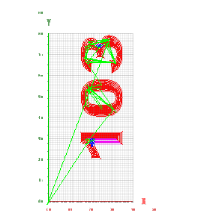

    Here it is.
  15. Peter Van Der Walt
    13,749
    4,070
    Both are centered around 2.5 inches in from X-zero, and 5 inches in from Y-Zero.
    But your Job Zero (origin) is not in the center.

    I see, Watching the videos they say to switch to the lower left corner for your Zero Point before saving it to to G-Code. So that is the issue?
  17. Peter Van Der Walt
    13,749
    4,070
    As long as you physically set the Origin of the job on the material by jogging/setting zero in the same relative spot on the stock as what you have told Vectric to do things will match up

    13,749
    4,070
    If you set that as bottom left of stock, then you have to jog over to the stock's bottom left and set XY zero there.
    If you set that as cetnter of stock, then you have to jog over to the stock's center and set XY zero there. etc

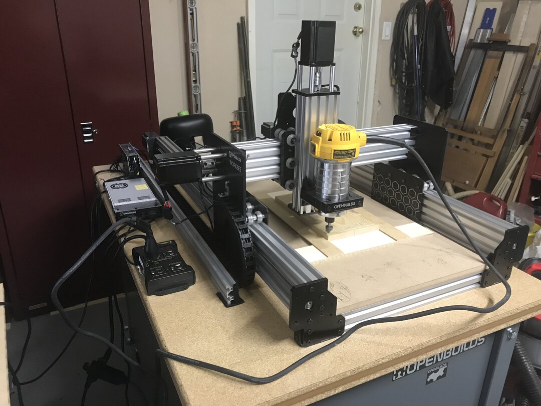

    You Know? I think I am visualizing my machine from the wrong end. I honestly am not sure what is the front or the back of the machine.
    Here is a picture.
  23. Alex Chambers
    2,680
    1,321
    You are looking at the front, which is nearest the camera.

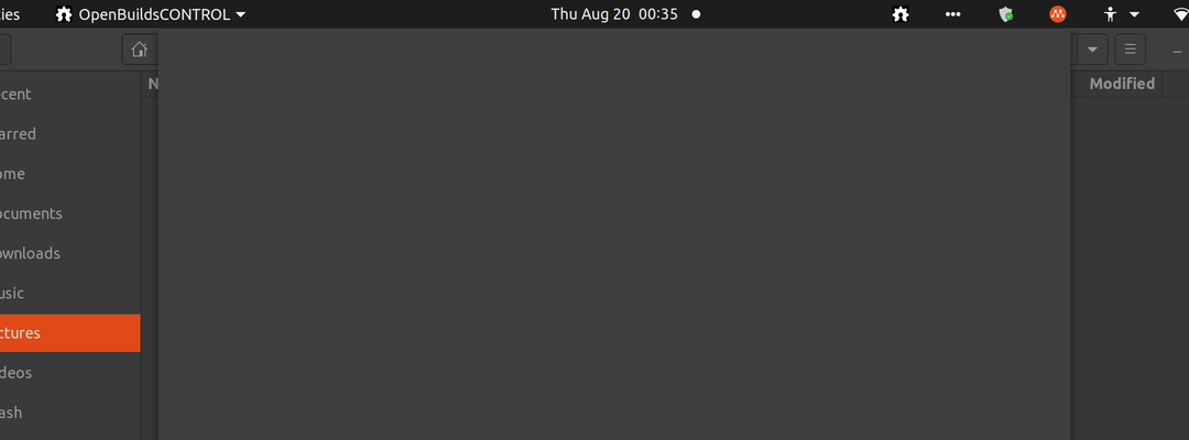

    Said I'd give 'OB CONTROL SW' a go (coming from CNCJs) but can't get it working..
    Running both the .deb file (after Software package manager installation) or the App image (after passing executable permissions) both result in an OpenBuilds icon appearing the top of my Ubuntu 20.04 OS.
    But when you click on Open User Interface GUI - the following happens >
    It's just a grey mass.. Any idea whats happening?
    Cheers, Michael

    Have you tried the web interface? I setup an Intel NUC with Debian and had to install it as an AppImage to get everything working (I don’t use Linux normally).
    If you try going to 127.0.0.1:3000 or the machines actual IP address on port 3000 in the browser URL this should show up the control software if it is actually running properly.
    Michael Newham likes this.
  26. Peter Van Der Walt
    13,749
    4,070
    Usually an indication that the WebGL flags arent set right by your Graphics Drivers. Update drivers (Kernel defaults doesnt enable WebGL fully)
