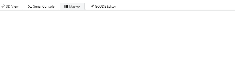

  3. txcomp
    txcomp New
    Sep 6, 2019
    34
    17
    I don't even have the little box with the + sign to add a new macro. The screen is completely blank.

  11. Peter Van Der Walt
    14,038
    4,122
    OpenBuilds/OpenBuilds-CONTROL v1.0.224 fixes the bug related to Macros - old macros will reappear, no worries
    Keyboard jog was stuck because of the stack error higher up related to Macros

  12. Peter Van Der Walt
    14,038
    4,122
    Thanks that was a big clue to finding the bug :)
    Nowhere :) but there was an odd bug in 1.0.223 thats been fixed in 1.0.224 - they're back, and better than ever (new buttons, allowing longer titles, and comes with keyboard shortcuts now - worth it!)
    Fixed in 1.0.224 - bug higher up the stack stops execution lower down too

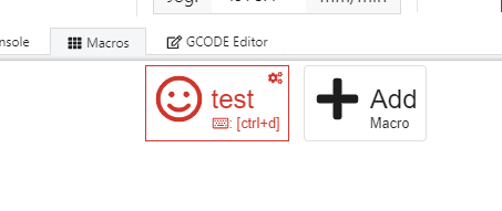

  17. gmorse7
    gmorse7 New
    Feb 20, 2017
    23
    Thanks for including custom probe capability!
    v1.0.226 incremental jog not working on control screen, continuous works on both control screen and probe screen.
    #1217 gmorse7, Apr 15, 2020

  23. KaosCNC
    KaosCNC Well-Known
    May 16, 2017
    94
    27
    226 updated and none of my jog controls work on my touchscreen - home works .....
    jobs will not run either.....
    Now my Windows 7 machine same issue.... no jog controls working.
    Laptop does not have touchscreen
    There must be an issue with 226
    rolling back to 224 -- should have looked for this before posting, sorry.
    #1223 KaosCNC, Apr 15, 2020
