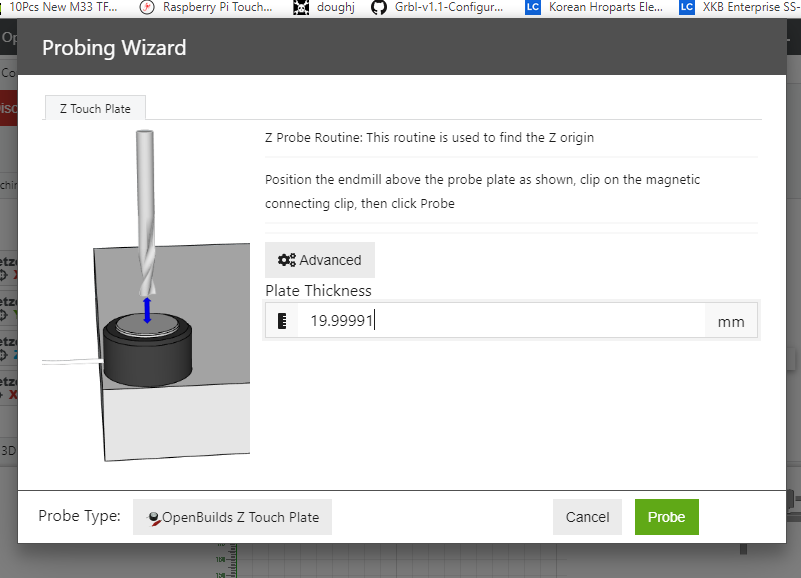

    New Z Probe wizard is only showing an option for the Openbuilds Z Probe. I am using a plate and there is no obvious way to change it.
    #1090 GeneLV, Mar 19, 2020
  11. Peter Van Der Walt
    14,038
    4,123
    Does it show the wizard for Z Touch Plate ? As that the only one we support at this time

    Yeah that is the one it shows. No way to have an option to show the previous probe options?
    Is there going to be support for others or just the one that we have to buy from you?
    Batcrave likes this.
  15. Peter Van Der Walt
    14,038
    4,123
    Will note the feedback :) maybe under an "advanded" dropdown (;
    Too soon to say for sure, but you always have the Macros panel for own probe routines

    I have noticed that after prob is completed when you hit okay the Z axis drives down not up. This is bad because the bit is on the probe when it tries to drive further down.
  21. MIke Antonacci
    Mar 26, 2019
    Just a correction to my last post. V1.0.214 when probing once the prob cycle is started is slowly drives down. When it finds the prob it then tries to drives down further at a higher rate of speed without the user doing anything. because the bit is on the prob it crashes the z axis.

    The log from the prob cycle.
    [10:05:32] [ $J=G91G21Z10F4978 ] ok
    [10:05:51] [ G21 ] ok
    [10:05:51] [ G10 P1 L20 Z0 ] ok
    [10:05:53] [ G38.2 Z-25 F100 ] [PRB:-620.472,-620.753,-6.496:1]
    [10:05:53] [ G38.2 Z-25 F100 ] ok
    [10:05:53] [ G4 P0.4 ] ok
    [10:05:53] [ G10 P1 L20 Z19 ] ok
    [10:05:53] [ G0 Z10 ] ok
  24. Peter Van Der Walt
    14,038
    4,123
    v1.0.215 will be out in a couple minutes with a fix :)

    Just installed v1.0.215 and tested probe it is working now as it should. Thank you for the support.
