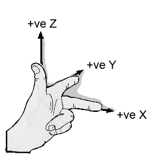

    A stupid question (even dumber than the last). When I'm homing the machine, what corner should the router end up in? Right now I would call it the "front right' if you are looking down the y-axis at the router. Also, for the Z-axis is higher from the surface the + or - direction?
    I am obviously new to this, and want to know if I need to flip any of my axes within the software to make everything work correctly.
    Thanks in advance for humoring a noob.
  21. sharmstr
    2,035
    1,431
    The homing direction should be wherever you put your limit switches Everyone does it differently, but there's a good number of us who home in the lower left. I prefer this way so that all movements away from home are in a positive direction. But again, its where you installed your limit switches.
    Spindle moves up in a positive direction. Spindle moves down in a negative direction. X moves to the right in a positive direction. X moves to the left in a negative direction. Y moves away from you in a positive direction. Y moves towards you in a negative direction.
    Here are two image that show the axis directions. The shape is different depending on what hand you use but the directions are the same. I learned from the start with my left hand, so I do this when I have to remember which direction is positive or negative.
    I've seen others do this with their right hand, but it seems hard for me to make that shape so I never use it. Again, its ultimately the same.

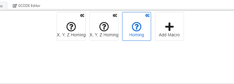

    C1FC9EFB-5B72-4EDF-B2A6-798760F28A58.png I'm going to ask what I believe is a very simple question but I've used search and can't find an answer. How do you delete a macro?? I have an add button and that's it. No buttons at the bottom or in any menu I could find. Can't right click and you can't select a button without running the macro. Delete key doesn't work either.

    Click the Gear (top right) on the button (edit), on the edit window that pops up there is a delete button too.
  28. txcomp
    txcomp New
    Sep 6, 2019
    34
    17
    I appreciate the quick reply!! I saw that little gear last night and every time I tried to click it, the *&^$%# macro would run. I went out this morning without the laptop hooked to the machine and was able to hit that gear every time. Got everything edited so I'm back to experimenting. Thanks again for the help!!

    :) take aim before clicking, the gear changes color when you hover over it to show you are in the right spot.
