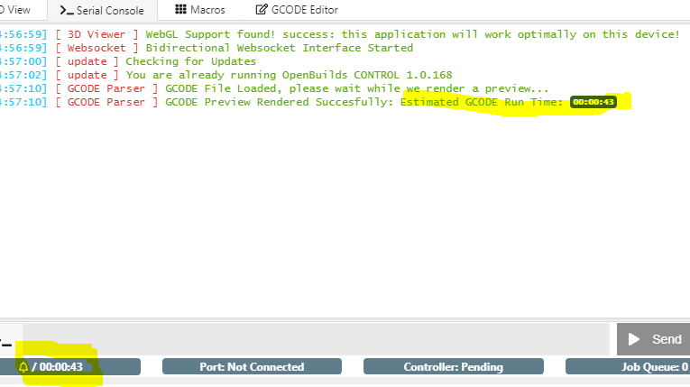

  10. jamin35008
    jamin35008 Well-Known
    Feb 7, 2019
    136
    44
    So I was going to try and use the new spoilboard surfacing tool in the OB control software soon so I thought I would load the file tonight so its ready to go tomorrow. Is there anywhere to see the estimated cut time for files within the control software? If there is I just cant seem to find it. Thanks!

  15. jamin35008
    Feb 7, 2019
    136
    44
    Thanks Peter. I think I made it sound like I was going to keep everything on overnight and have it ready for the morning but I was just getting the settings into the control to see how everything looked. I don't have the OB control in front of me at the moment but is the cut time available to see before starting the job or only once you hit start job? Just wondering how to judge how long the spoilboard surfacing I loaded is going to take. Thanks!
  16. Peter Van Der Walt
    13,749
    4,070
    Not at this time.
    But if you connect to a controller (and keep power off) as soon as you click Play, remaining time starts counting down.
    I'll add a Estimated Time somewhere in a future version though but hey at least, for now, there is a way if you really need one

  20. Peter Van Der Walt
    13,749
    4,070
    Just a heads up that it didn't make it into last week's release but that code did make it into a next release :) coming soon estimated time.PNG
