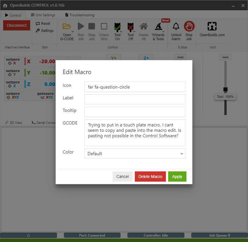

    Trying to put in a touch plate macro. I cant seem to copy and paste into the macro edit. Is pasting not possible in the Control Software?
  21. sharmstr
    2,036
    1,433
    Used to be. Let me check. I havent tried since the keyboard shortcuts were added.

    jamin35008 Well-Known
    Feb 7, 2019
    136
    44
    Are you using you mouse to do that or the keyboard short cuts?

  25. jamin35008
    Feb 7, 2019
    136
    44
    Got it. Thanks! Was trying with the mouse.
