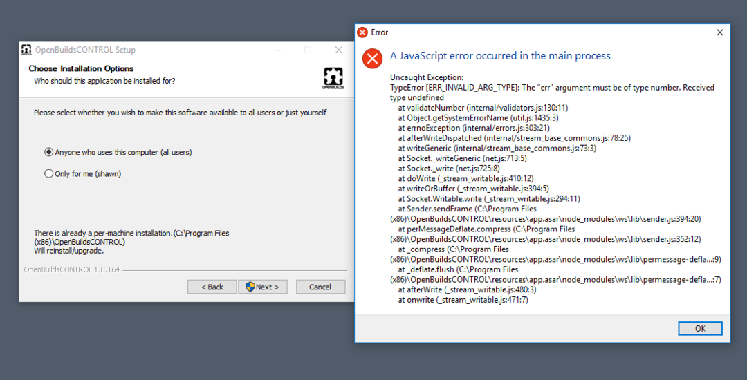

    Just hit a snag.
    Everything working great, ran a gcode drill program ran good, ran next gcode engraving program it ran good, then when I loaded the next gcode program it said Gcode Opened: in black letters in the Serial Console and nothing came up. I mean no program displayed.
    So switched to 3d view and saw a small black bock with a frowny face in it. This was in the top left hand corner.
    I have reset the controller and the cnc, and have tried to load other gcode programs that have worked in the past. same result.
    Openbuilds control seems to be functioning, it connects, disconnects, homes, macros execute ok, z probe is ok.
    Any hints ?
    I have tried to load old programs that have worked before to no avail.
    Programs were made with aspire, running win 10 with all updates, Openbuilds V160, cnc is a sphinx 1050 with xpro v3

    Further to previous post:
    downloaded v162 and attemted to load it, it wouldnt install. Came up with a "java script error occurred in the main process".
    So I tried to find my original download of v160, and couldnt find it, so I reinstalled my V 156.
    It loaded and is running correctly.
    Homings ok, Macros ok, Z probe ok, gcode programs load and execute ok.
    At least I can finsh my project.
    Know where I can get a copy of V160?

  7. Peter Van Der Walt
    13,992
    4,107
    Busy night :) So let me group the replies:
    @Michael Laley:
    You should be fine with 1.0.162 but I think your PC hasnt done the update right...
    The bug that was in 1.0.161 was definately fixed in 1.0.162. How sure are you
    - That you did update to 1.0.162? Maybe your PC didnt remove 1.0.161 and thats what came up after boot? Maybe needs a uninstall then reinstall?
    - That is the same error? Please screenshot the error (try catch the whole window in the screenshot, theres always clues in the background behind the error too)
    CONTROL is not Java based. Javascript is a totally seperate language, in this case running under NodeJS/Electron. No need to install Java or anything else, the application is 100% selfcontained
    @Steveathome - Yours might be an issue with either the GCODE you load, or WebGL drivers. Glad to help you troubleshoot further but gonna need some screenshots :)
    I've never seen a Frowney Face? (didnt code one in...), so please catch a screenshot? If the gcode fails to load its usually a problem in the gcode itself (not compable with the GCODE spec, in particular the Grbl based dialect)
    The issue you see was software based. Try a reboot or Quit and restart CONTROL (System tray icon -> Right Click -> Quit, then start it again) Resetting the controller wont affect the software side.

  19. Michael Laley
    Jun 22, 2018
    I get the exact same error. Uninstalled control software, re-installed and same error. I removed.161. v.162 did not fix the problem. I guess I'll go back to v.158 or something because it works. Had no problems until v.161.

    Hi there seems to be something wrong with the new update - I get the error too. I can open the program from the task bar as it is running in the background. I can connect to my machine (C-Beam using the smoothie brd) but none of the controls work - when I try to move or even enter a g-code (ie M114) nothing happens? where can I find the earlier versions? I have done the uninstall / delete the user data folder. Running on Windows 10

  23. Peter Van Der Walt
    13,992
    4,107
    Sweet, thanks @Kevin Brewer with good screenshots that does prove a little more than what I was having to work from before. Will dig in a little later, I cannot reproduce the error here (everything works fine here) so not sure whats different about your PCs yet
    @Michael Laley @Steveathome - Will check and release a new version soon

  26. Peter Van Der Walt
    13,992
    4,107
    I've PM'ed Steve, Michael and Kevin with a link to a prerelease to see if it helps with their error
  27. Peter Van Der Walt
    13,992
    4,107
    v1.0.164 is in your updates from today :)

  29. sharmstr
    2,035
    1,431
    Upgrading from .162 to .164 throws and error. It doesnt seem to effect the upgrade though. Just click ok to dismiss and continue with upgrade.
  30. Peter Van Der Walt
    13,992
    4,107
    Did a quick sanity check here: Installed 162, opened it, etc.
    Ran 164, no error :(
