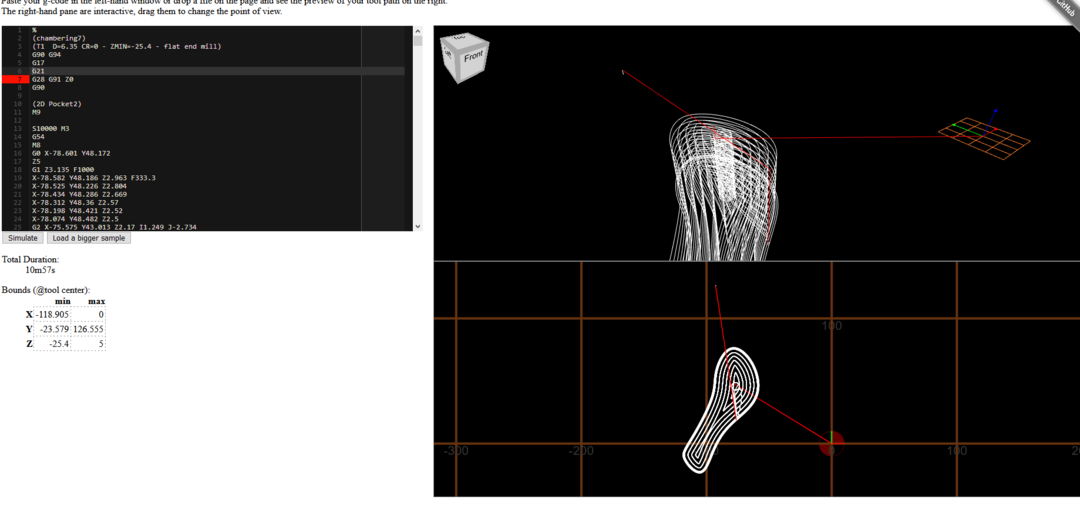

    So I'm trying to mill cavities in a guitar body to lower the weight. I have a simple fusion 360 design and output the tool paths to the grbl plugin. Other than having to remove T1 M6 from the gcode this generally works fine.
    I've since switched to the black box (neat) and openbuilds control.
    The issue I'm seeing is that the first cavity in the guitar body is milled exactly as expected. Once it is done it trucks off in the wrong direction to go to the second cavity. Here is the first part of the toolpath. It does that cavity and then the final red line is the trip to the second. Instead of raising the tool it is plunged deeper and heads in the opposite direction. This hasn't been great for that body.
    Any ideas where I'm going wrong? Fusion 360, this weird gcode preview thing I found on the web and openbuilds control all show the same, correct, toolpath.

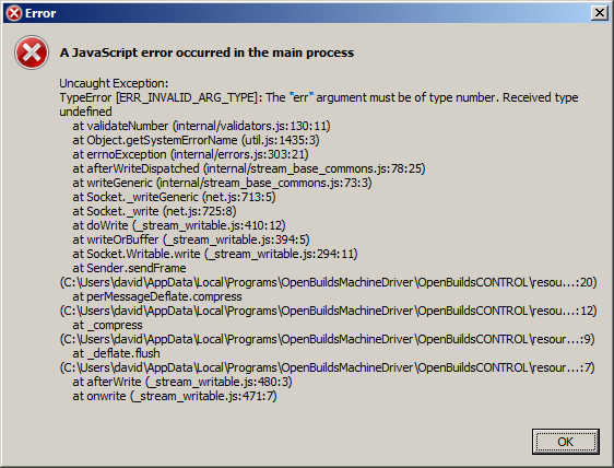

    so i loaded the chambering7.nc file in control. just as it finished rendering it said it wanted to update.180 to .185, I clicked yes, it did this and then updated ok
    14,001
    4,113
    That bug during updates was fixed in 1.0.184 (but only released as 185, 184 was internal only) - so Wont happen again :)

    So, after some fun that behaved somewhat differently but still kept the bit down at the first cavity. The gcode simulation shows the bit coming up and then moving to the second cavity. Not sure what it was showing at the time of the failure as it induces a heart attack every time.
    I wonder if it is the final finishing pass that is giving me grief. Cavity is 1 inch deep. Tool's cutting length is 1 1/8 inch so that shouldn't be it. Even so it would do 1 or 2 passes (2, I think) and then lift and go to the second cavity.
