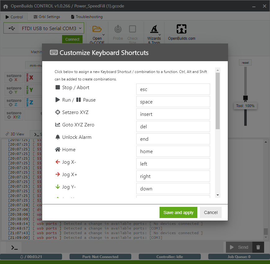

    Is there a list of keyboard shortcuts anywhere. I just found out that if I press enter it runs the job, even if the probe window is up.
    What I really want is what keyboard shortcuts are there for selecting step increments. But having all of them would be great too.

    Click Wizards and Tools > Customize Keyboard Shortcuts to not only view current (default) assignments, but you can also set your own :)

    Is it possible to restore the keyboard defaults? - I messed up but can't find a "restore defaults" option/button, thanks
    14,870
    4,283
    Not easily no, but just go through and reassign whatever buttons you want for each function. If the ones you want to use are already assigned just temporarily assign something else to the one you want to free up.

    been scrolling old forums looking for any info before i commented, but i am wanting to set a axis shorcut key. i have a shuttlepro which has a scroll wheel that i would like to use to move the cnc. i wanna set a button to the X axis and then be able to spin the wheel and jog the machines. any info

    A-Axis shortcuts is coming soon, but not available at this time (next version)
    Other axes are already there, in Wizards and Tools > Customize Keyboard Shortcuts

    I did not mean A axis....... sorry for the confusion, as of now in the shortcut area you can select to jog (X+ or X-) for example. what i am looking to do is to be able to press a button on the shuttlepro that will select 1 of the 3 axis (xyz), to then give that axis the command of the scroll wheel for when i jog. this is what i have and for example if i made (X axis = button 1) then i could use the scroll wheel to move the X axis. then another button for the Y, and so on. hope this makes sense.

    CONTROL accept keyboard inputs. Any other device you want to use is only usable if it can be configured to pretend to be a keyboard.

    I want to press a button that has been programmed to select X axis, then have another button that selects the Y axis and same for the Z, after I press the button I want to be able to move the jog wheel to move the desired axis...
    As of now it's set up program a button to X+ and then another button to X-......
    I want a button for just the X axis then use my wheel to decide rather positive or negative...

    Understood, but as is, only keypresses as shown in the wizard is understood by the application. Anything else you want to do is either programmed externally or just not going to happen.

    there are various keyboard macro packages that can probably do it, you will have to do the programming though.
    AutoHotKey is what this guy uses to configure 3 keyboards to do amazing things in his video editor.
