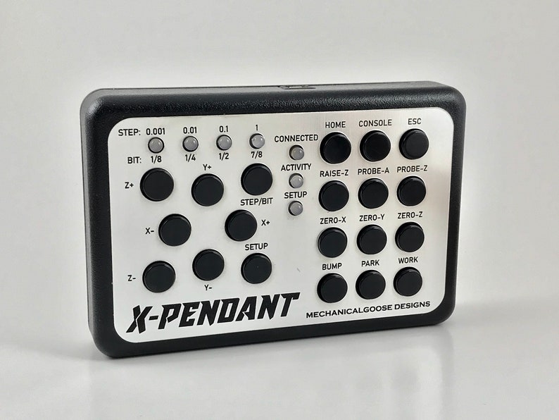

    I have a few suggestions to make control a little more user friendly. I have a lot of experience running CNC machines and I see a few things that would improve usability greatly. I was able to get control running on a Pi and that is awesome! so far so good.
    the first suggestion I have is to either make the jog increments adjustable by the user or change the increments to (.001; .01; .1; 1.0) for those of us who work in inches .01 is not fine enough if you are using an edge finder and locating the edge of stock precisely. my machine is a converted mill with ball screws and can utilize this small of a move.
    and while we are talking about jog increments. it would be cool if there could be a keyboard command that would set each increment. rather than cycling through the different distances. a button for .001, one for .010 and so in. if this can be done, a pendant could be made that could have buttons with the different jog distances and would be a matter of pushing the button and jogging. maybe this can be done with a macro but I am not sure how that would work.
    something like this...
    Control looks to be a very promising option for DIY CNC control!
    Thanks!
    Tim
