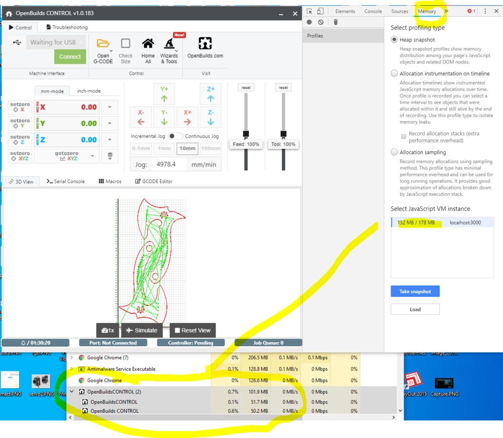

    So some additional guidance for troubleshooting:
    On OpenBuilds CONTROL: Press F12 to bring up devtools. Resize window a little so it all fits. Go to the Memory tab (Screenshot shows the gcode I have loaded there along with all the other GUI memory totals to about 132MB, peaking at 178MB. When there are active webworkers there may be two lines (each worker gets its own JS VM)
    Below that you can see Windows Task Manager peaking out, I can see Control has two threads spawned, barely using CPU, around 50MB memory per process (Backend, and GUI runs each in own process)
    So do similar for yours. When it gets hung up, lets see what those stats look like (as well as providing files etc of course)
    Also keep in mind, your PCs experience it :) so if you need to run for a while to get it to happen, why not power off your CNC, but stay connected. Run the job (wont move as power is off) but that'll make it run long enough to start seeing what the loads do, and give you the chance to get the information without actually machining.

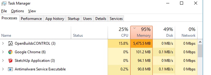

    Peter, it happened again. Seems like it's related to time the software is running vs the complexity of the job. Did a few very basic jobs this morning, then let the machine sit (software and hardware up and running, router off) for a few hours. Came back, and the software was very unresponsive. Got it to run a job, but it slowed down and I couldn't stop it. It also was able to jog, but was very sluggish.
    I captured what I think is the pertinent data you requested. If it's not, I'll try again. I'm fairly certain I can reproduce this reliably. The images I'm attaching are my computer info (for CPU/mem/OS), video card info from the AMD/Radeon app, the task manager screen cap when it happened, showing what appears to be OpenBuilds hogging up CPU and Memory, and the F12 snap as well.

    Just an update. Left the Openbuilds Control software running overnight. Not running a job, just running on the PC. Came in today and PC was unresponsive. Checked task manager and found OpenBuilds Control was using 5.5GB of memory. I killed it, and it resisted it seems, and didn't stop cleanly. It slowly bled off allocated RAM. Took this snapshot when it was still using over 3GB.
    Peter Van Der Walt and Rick 2.0 like this.
