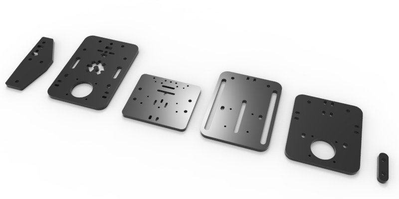

  23. Paul Busby

  28. Paul Busby
    Apr 3, 2018
    Could you 3D print the plates? Although I might have a way to get them laser cut. The finished cutter isn't able to do 6mm acrylic is it? Just a mad thought to print plates to build it and then cut new pieces.
    I would plan to run a 24v system using the arduino and CNC shield with some TMC2100's. I do have a spare smoothie ware board but think this might be a bit more work than is needed
  29. Mark Carew
    2,746
    2,412
    Yes you can, in fact I think I did see one of the guys here did just that. Not sure where the files are so I have included a zip of all the ACRO plates in STL format to help get it to 3D printing a bit easier. Both in group format as well as individual plate stl
    GrayUK likes this.
  30. dragonfire81m
    Jan 17, 2017
    15
    I have some modified Stls on Thingiverse just look for the group acro system
