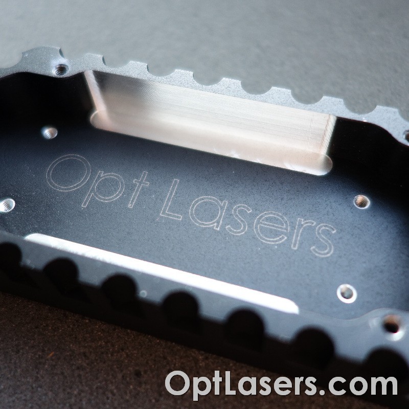

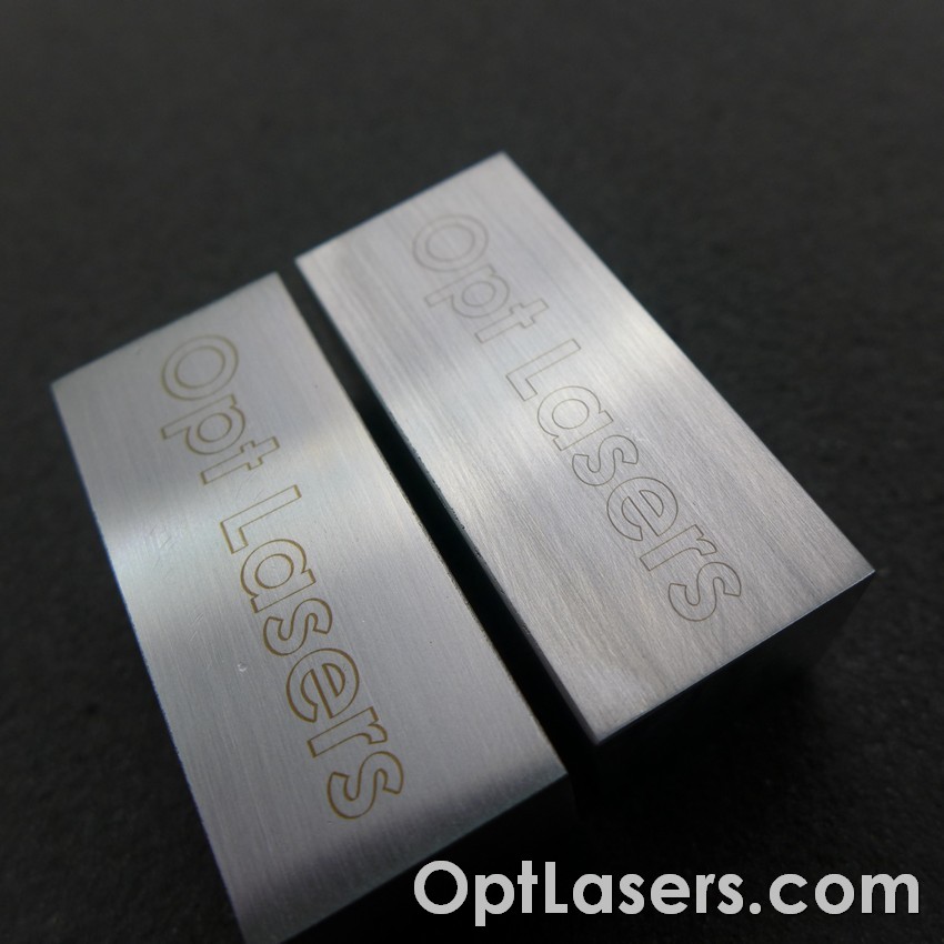

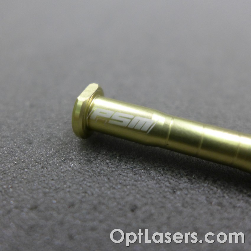

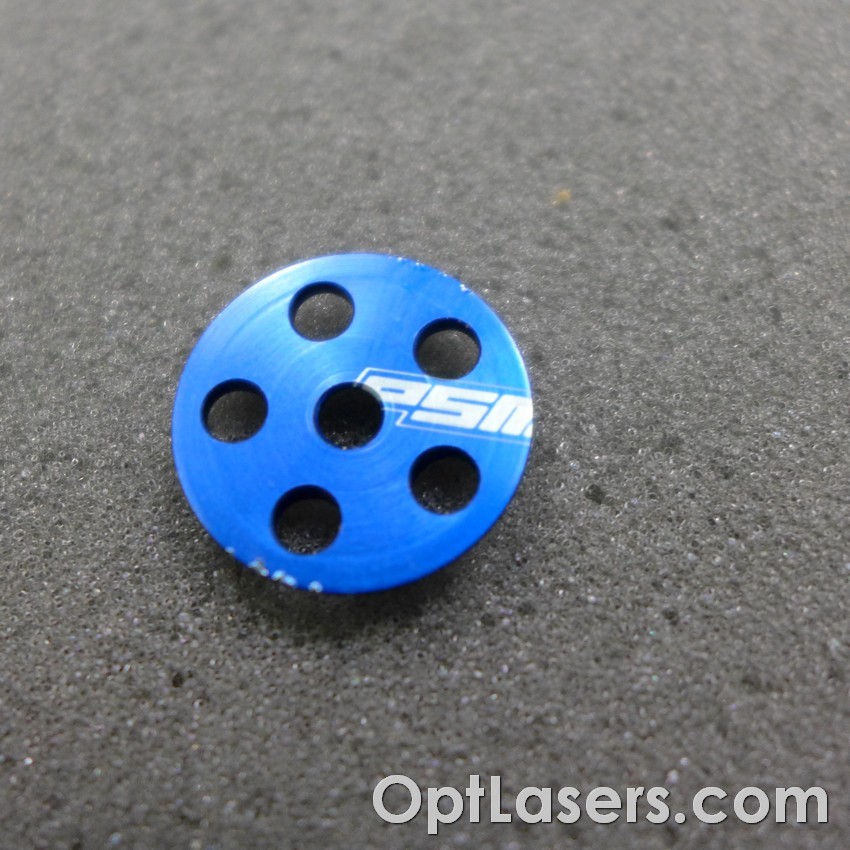

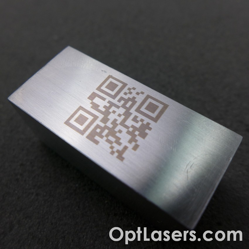

  17. Opt Lasers
    May 4, 2017
    Etching directly on any metal is not that easy. There are two two things messed up pretty often. Marking and engraving.
    Simplifying: Marking = changing of the colour, engraving = removing the material, etching is more like removing of course.
    Using a spray - we did not test this, but this may work, I will write to the producent to get some samples for tests.
    Anodized aluminium is possible to engrave (since we remove anodized layer) but anodized layer should be a little darker. BUt even gold enodization works. Here are the results for example:
    It was done wit ha speed of 50mm/s and beamspot size around 0,2mm diemeter.
    Using 6W (2,8 can work too but is barely visible) you can mark stainless steel or titanium, but not other metals.
    You can see that focus distance changes the line width. Short focus make the line more equal in both directions but it isless visible (even with higher power density). Speed used - 3mm/s
    Stainless steel (Engraving)(#5.3) 3mm.s step 0mm (1 pass) Focus 30mm.jpg Stainless steel (Engraving)(#9.4) 3 and 0,5mm.s Focus 30 and 60mm.jpg
