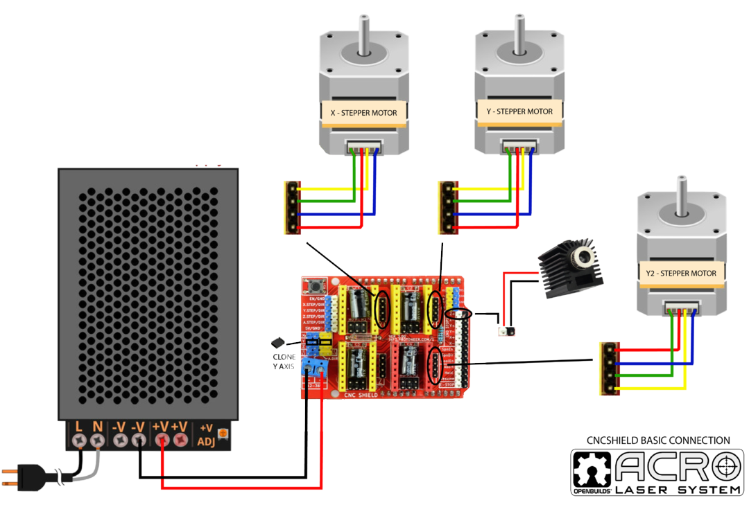

  5. Leo Chan
    Leo Chan New
    Jun 6, 2018

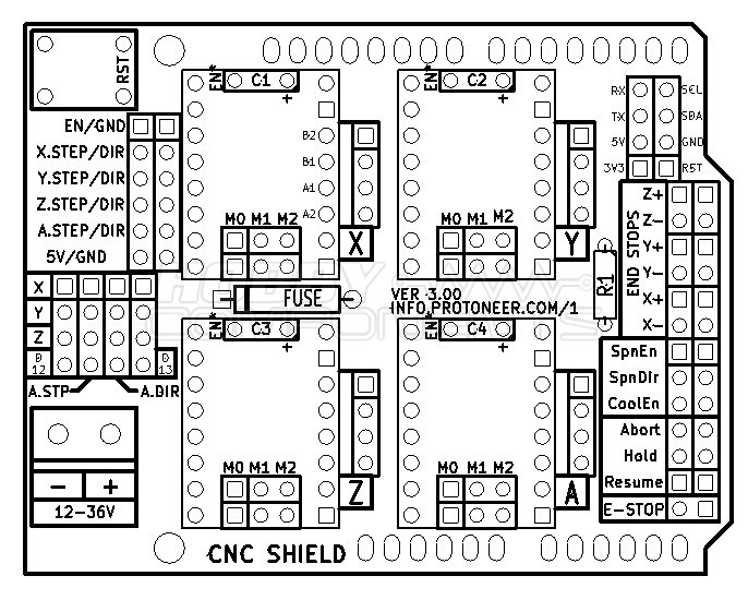

    That diagram shows the laser attached to the PWM control pins.
    If you have a diagram of the connection, why did you ask the question?
    I’m confused about what you want.
    Edit: well that diagram certainly does show the laser connected to the Z- endstop pin... are you running modified GRBL code?
    According to Protoneer, the designer and maker of genuine CNC Shields, you connect a laser to the SpnEn pins: Laser TTL - Protoneer Product Forum

    Further confusion...
    Protoneer say to use SpnEn, openbuilds say to use Z-
    GRBL Shield help.
    I’ll send an email to Bertus (the designer of the CNC shield) and get a definitive answer. Although I’m not sure Openbuilds aren’t using Chinese cloned parts, so it may be more appropriate to make them do the heavy lifting for saving $10...

  9. Rick 2.0
    2,861
    1,528
    Which version of grbl do you have installed on the arduino?
  10. Leo Chan
    Leo Chan New
    Jun 6, 2018
    GRBL version 0.9j
  11. Rick 2.0
    2,861
    1,528
    During the process of upgrading grbl 0.8 to 0.9, pins 11 and 12 on the Arduino were swapped to give pwm output to the spindle. This resulted in swapping the SpnEn and Z+ outputs on the board. Protoneer revised their boards to the proper pinout starting with V3.10 but the Chinese V3.00 opensource boards (falsely labeled as Protoneer boards) do not reflect the pin change. But the output labeled Z+ on the V3.00 boards does map back to the actual SpnEn pin when using grbl V0.9 or higher.

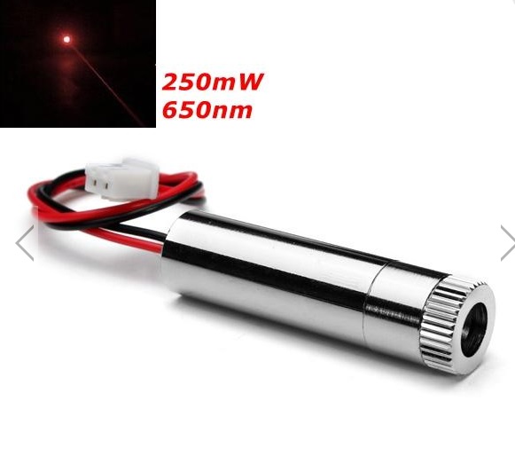

    If what you have is the same as that picture, you’re missing a constant-current laser driver, heatsink, fan, power source.
    All you have there is a diode in a holder, no control electronics, no way of managing ttl/pwm.
    You cannot just add that to a CNC controller and expect it to work.
  14. Leo Chan
    Leo Chan New
    Jun 6, 2018
    So any TTL Module suggestion? Something cheap and functional?
  15. BNMaker
    BNMaker Well-Known
    Jul 13, 2017
    62
    38
    I was wrong. Your module does contain a driver, but doesn’t support ttl.
    Plus, at 200mw, I’m not sure what you expect to do with it - it will barely mark paper.
    It’s a laser pointer, effectively
    https://www.aliexpress.com/item/New-Focusable-Laser-Module-Red-Dot-Laser-Generator-Diode-200-250mW-650nm/32596767779.html.
    If you want a usable laser, x-wossee has a great TRUE 4.5W unit for US$99 that can actually cut and mark stuff. https://www.ebay.com/itm/4-5W-Engraving-Laser-Head-with-thermal-protection-PWM-NUBM08-455nm-445nm/152781917480
    That only needs a 20x20 heatsink and fan and will plug straight into a 12v power supply and your PWM pin and can actually do decent engraving and cutting of things like 3mm ply/mdf, 1-3mm black acrylic, balsa, fabric, cardboard, and can even engrave coated metal plates.
    Sorry for my previous response - it was late and I didn’t notice the power of that diode module and just shot from the hip.
    What do you want to use a laser for? 200mw is 1/5 of a watt - and even with a watt you would be pushing it to mark paper.

    20
    So does that mean a proper board bought from Protoneer should be on the SpnEn pins? Something to try I suppose since on the Z+ pins the laser is always on. It is confusing since Arduino CNC Shield – 100% GRBL Compatable shows that the d11 pin is the Z endstop.

    4,117
    Protoneer has updated Grbl 1.1 compatible boards, or save yourself even more headache and get a CNC xPRO V4 Controller Stepper Driver (clearly labelled, well tested and supported natively in all our software/videos/examplesettings, etc
