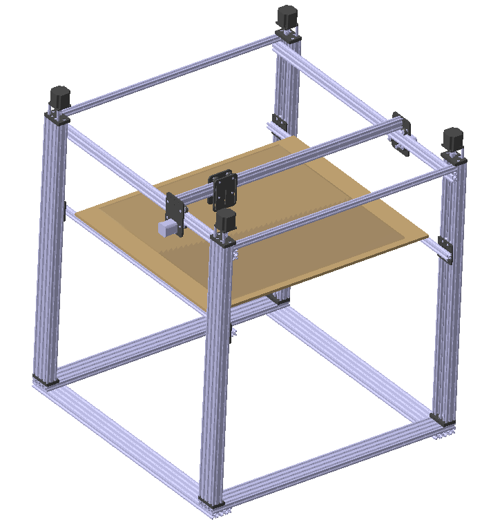

    Hi,
    I apologize if my question has been answered already... I tried the search function, but did not find any answer.
    Would the ACRO system be a good option for a 3d printer, to move in the X and Y directions ?
    In other words:
    Is it accurate enough ?
    Can we reach acceleration/jerk and speed settings suitable for 3d printing ?
    I am working on a new project, and I have to admit that the ACRO system looks really nice and simple !
    Thank you !
    Jacques

    Thank you for your reply, BNMaker.
    The ACRO system would only be used to drive the X and Y axis, at the top of the printer. The heat bed will be moving on the Z-axis, below the ACRO system.
    So the printer would be a "cube", with the ACRO system at the top.
    I was wondering if the ACRO system can reach speeds around 50 mm/s, with acceleration around 1000mm/s/s, without skipping steps. If it can go higher, even better :)
  11. Peter Van Der Walt
    13,992
    4,107
    It should yes. I vote, go for it. I wanna see a Acro printer. Acro was always designed as a modular XY system to begin with, not just as a laser plotter

  17. Jacques D
    Jacques D New
    Oct 9, 2016
    49
    13

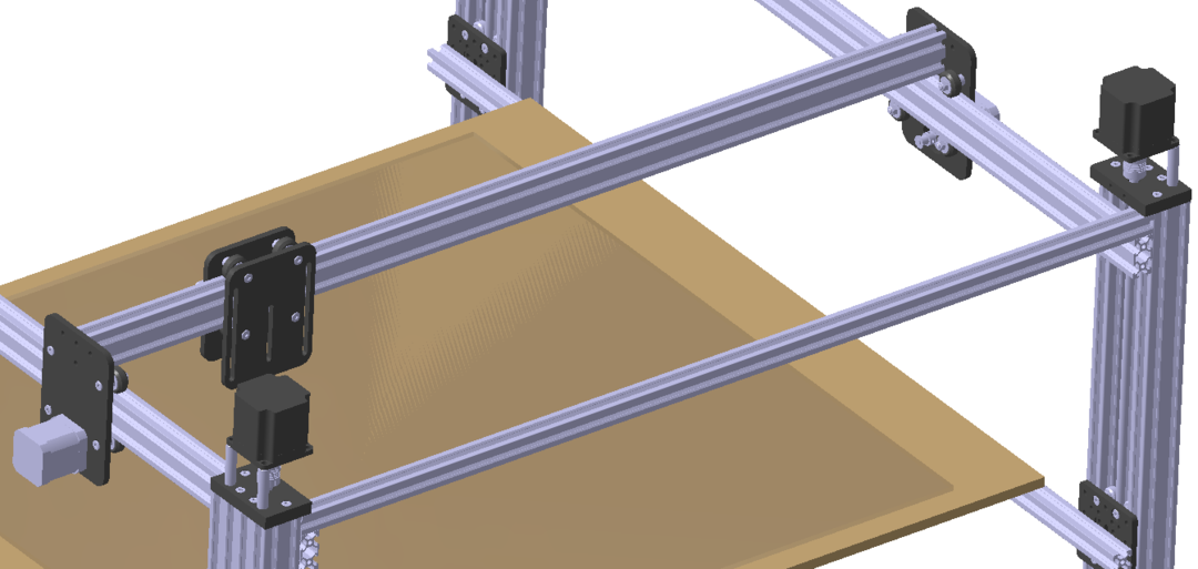

    I am completely unfamiliar with sketchup. Maybe I'll give it a go one day.
    In the meantime, here is what I started to work on, with the software I "know" (that's a bold statement):
    This is a first rough draft.
    I know, the four C-beam actuator are overkill, but I want to re-use what I have and that seems like the easiest option. Maybe I'll post a build if I get a sketchup, when it will look more definitive.
  18. Peter Van Der Walt
    13,992
    4,107
    Yeah :) best we dont hijack this thread. Your software is fine too, doesnt have to be Sketchup, nice renders posted allows the community to see and talk about it too
