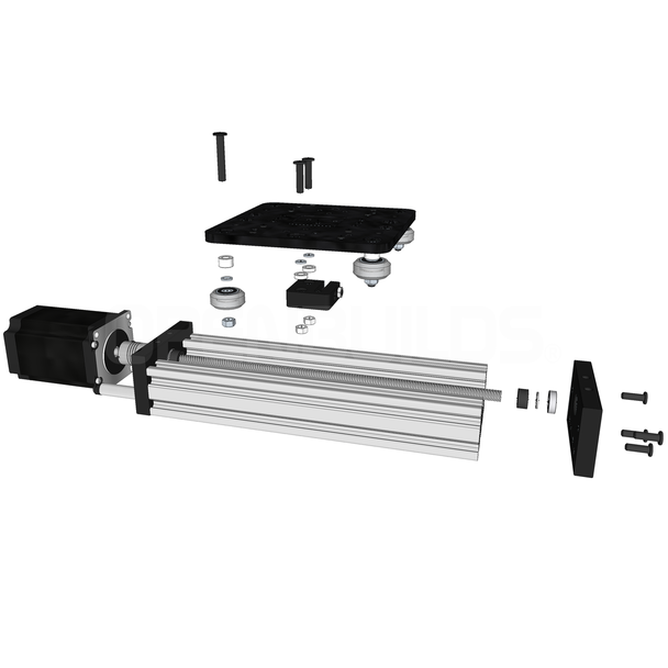

    I'm not home now but I'm pretty sure my z axis acceleraion is 500, my lead screw length is 290mm. I think that may be the problem.

  3. Sam Keller
    Sam Keller Well-Known
    May 20, 2020
    80
    86
    It could be if the screw is in too far it could bend that top thread out if line.

    Ok, I will check them out. As for my z binding, I still don’t think I have solved that problem. The back lash nut that I ordered from openbuilds, is it directional? Is the adjustment screw to prevent the z axis from falling down when the motors are off?

    No that would be way too tight. Its just to adjust out any play on the nut. Play causes backlash, and its name says it all :)

    is the backlash but directional? Could it be what is causing my issue with z sounding bad?

    I have the adjusting screw in top. I do not know if makes a difference what direction it is

    It does not make a difference no, wherever future adjustments might be easier would be my personal suggestion

    Do you have the spacers between the nut block and the plate?

    Very good question Sam. I’ll have to take it apart and make sure I didn’t leave those out when we changed z height.

    Here are a couple updates:
    We took the gantry off and disassembled the z axis lead screw. Everything really looked ok. Upon reassemble, we noticed where the lead screw/motor shaft coupler appeared to have been rubbing on the top of the z axis. I am wondering if the coupler loosened and slid down the motor shaft until it was touching the top of the z axis and was causing the problem? Either way, we moved it up and retightened and it does sound better. I am hoping that solved the issue.
    Also, as for the noise/limit switch problem, we made the adjustments on the pc side that were recommended above and I also added a 100nF capacitors to each limit switch line at the Arduino. As of now, this has solved the issues I was experiencing with the homing stopping prematurely and the jobs randomly stopping while running.
