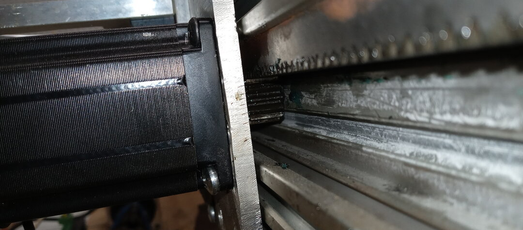

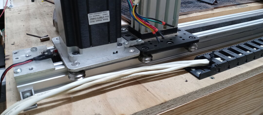

    It's been quite a while... I got tired of messingwith the belts, I was really getting a sling shot effect when cutting in the middle of the bed so I went to rack and pinion. Found some pretty cheap in Missouri and it works great. It took a while to get it lined up square and the gear mesh right but it's much better than the belts. I also changed to steel v wheels, i like them better too. I probably didn't do it the best way but that's how I do stuff...

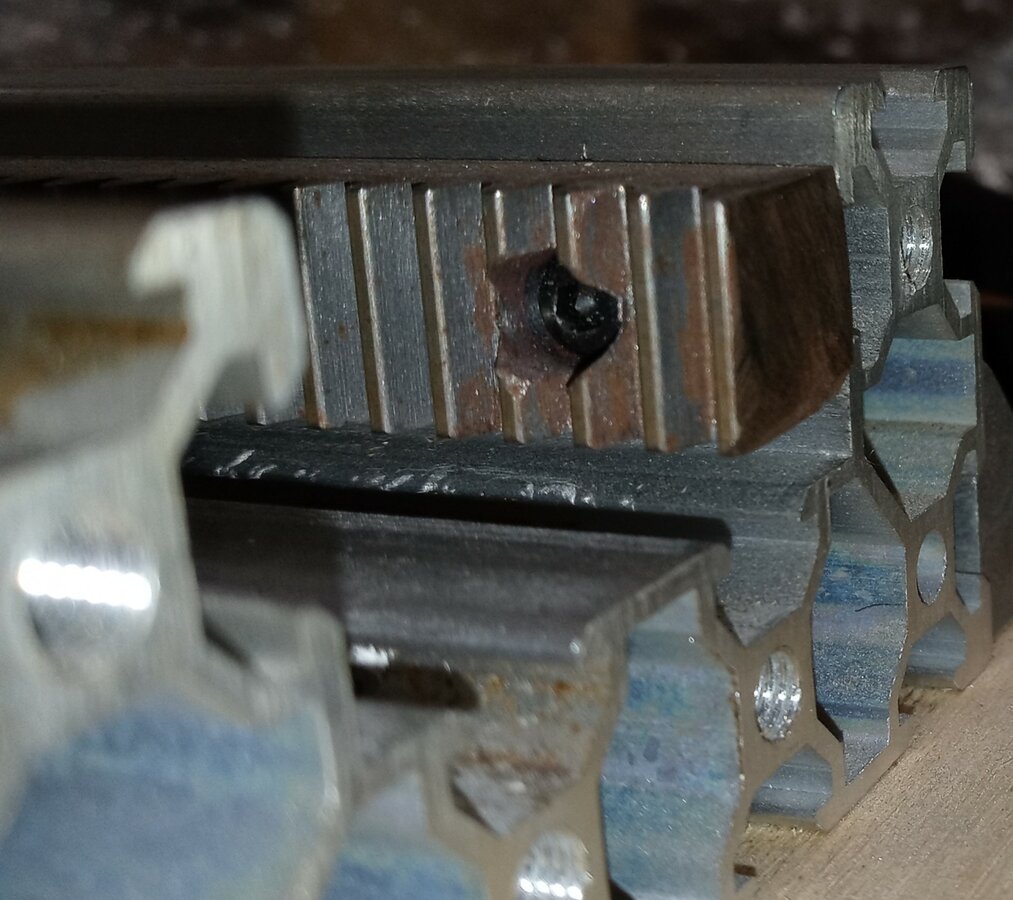

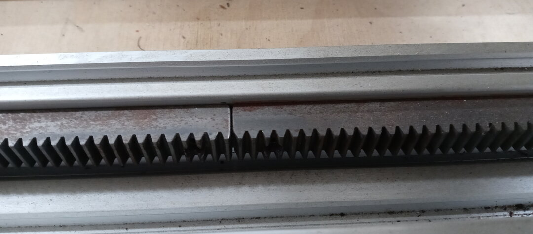

    I bought 4 of the R2020x6 ft 20 pitch 1/2" for $216 shipped 6 months ago. I bought the gears on amazon. I used m3 screws and countersunk them. I butted them together and ran the gear across the joint until it was smooth then tightened the screws. I runs smooth over the joints and screw holes. Prob not the best way to do it but it works for me.
