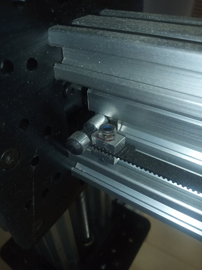

    Not a problem Chuck, i should have taken more pictures when I was putting it together.
    1. The aluminum angle on the bottom of the gantry is to hold each end of the belt. The angle is screwed to the bottom of the gantry with 2 screws into 2 existing tapped holes. Then I tapped one hole in the angle side pointing down to screw in the belt clamp.
    2. On the aluminum plate between the c beam and the motor mount, the 4 outside holes are thru holes and i used the v slot nuts for those 4 screws. The 2 inner holes are drilled and tapped in the aluminium plate for those 2 screws.
    3. Yes i think the c beam can hang over the table 3-4 inches.

    Sam,
    I see one end of belt attached to z axis but not sure how the other is and how to tighten it. How much tension is on these? Really tight?

    Hey Chuck, the belt on my gantry is held at each ends with this contraption. It has worked great so far, i was able to get it plenty tight by hand.
    Both ends of the belt on my long rails are clamped to the aluminum angle under the gantry cart and then loop around the motor pulley in one end and loop around the belt frontier in the other end. Does that make sense?

    I'm sorry Chuck, the 3GT pulleys at the top of the list are the wrong size, I meant to edit those out. You should return those if you can. The belt is a 2GT. If you bought the same motors, they have 8mm shafts so they would use the same pully, 2GT 20 tooth with 8mm bore. The 2 belt tensioners use the 2GT 20 tooth idler pulleys with the 5mm bore. And the 2 smooth idler pulleys go on the top gantry cart.
    The long rail belt is not real tight. I tightened too much once and popped the belt out of the clamp. It looks flimsy but is pretty taught

    That's an interesting choice you did here. I had done it with the belt teeth meshing together. Bonus effect is you don't even have to clamp them together supper tight. :D
